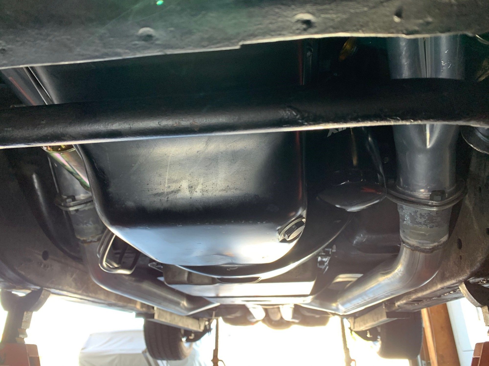

I bought new shorty exhaust manifolds for my 68 Camaro RS , but the collector hit the chassis at the slant for the floor board . It didn’t turn down enough to clear that part of the firewall . Can the forum recommend shorties that will fit , turn down enough so that I can connect my exhaust ?

If your 68 is a small block automatic, The Patriot headers I have fit very well. They are more a "mid length" header. Any header will not be a direct bolt on to a stock exhaust but any muffler shop can make up the connecting pipe section
1967 CHEVROLET CAMARO Patriot Exhaust H8021-1 Patriot Clippster Headers | Summit Racing
