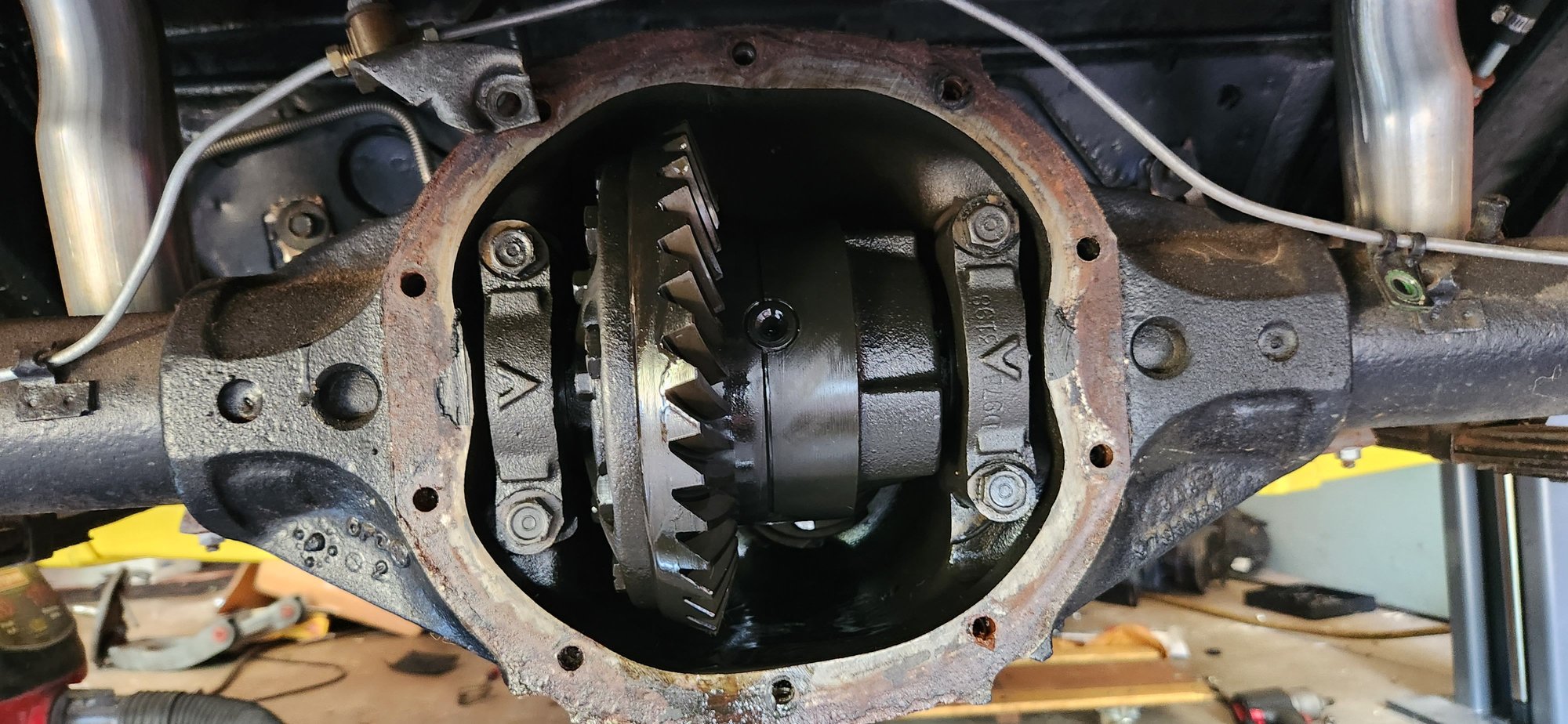

Changing out the brakes on a 69 Camaro to disc. I need to remove the rear axels yet I cant figure this one out on how to remove them. I cant even figure out what diff this is. It also dose not appear to have C-Clip eliminators.

Unfortunately my diff does not look like that as you can see in the pictures. Wish it did. I have some sort of after market diff that I cant ID.

Hmmm,does it have the bolts behind the hub like this or no?
If not it must have c clips in there.
There's no way to release the pin holding the shaft for the spider gears?

Thanks for the help. there was no pin for the spider gear. I put a drum on backwards and hit it with a hammer. I just didnt think GM 10 bolt had a setup like this, kept looking for a pin and c clips.

Well it's probably an aftermarket differential inside a GM 10 bolt rear end but what make ?
Did you get the axle out?

Yes I got it out fairly easy, just a couple wacks. I still have no idea what kind of diff it is.

So it did have the bolts behind the hub holding it in then.
If memory serves I had an old '60's1/2 ton pickup like that but my memory is questionable. lol
