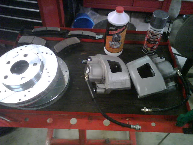

A single piston brake caliper has one pressure point. Picture a banana like brake pad and you press on it with one soda can. You not going to get the full effect with a single can. Now picture two smaller soda cans pushing the same banana and can see how the force would brake more evenly. In 1998 GM switched all Camaro over to dual pistons. Drum brakes where standard on the 67 but if you ordered the upgraded brakes you or the duel pistons Corvette caliper. You will also see four or even six piston calipers, these have pistons on both sides of the rotor.
Keep in mind that updated after market brakes will require larger rims.
Cross brace is the metal plate with the X in the center. It is help on by 6 bolts just at the end of the trans.
1998 twin piston Caliper
Not the greatest pic but these are the 1996 single pistons calipers, 1998 Brake pad is a good bit longer.
