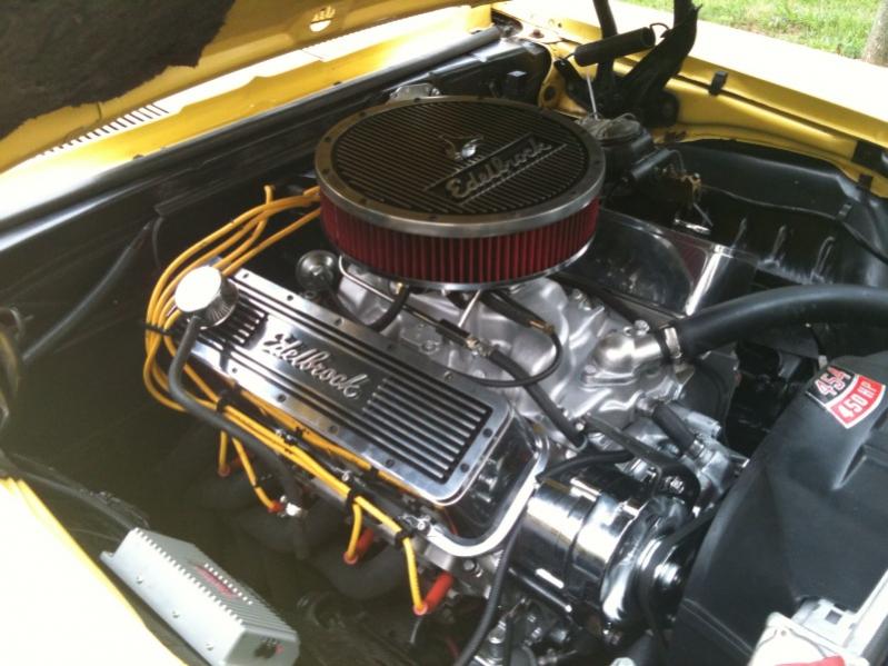

need advice on electrical draw. 69 camaro, 454, 4 spd, mostly stock wiring harness. No major electircal issues (everything works - plus I added a couple extra grounds here and there - just to have them)
Battery slowly drains when sitting.
- New battery. Alternator works fine, charges it right back up.
- Have you seen any trends in the 1st gen to lookout for?
- Easiest/cheapest way to isolate the problem?
Thank you kindly for any advice.
Frank
