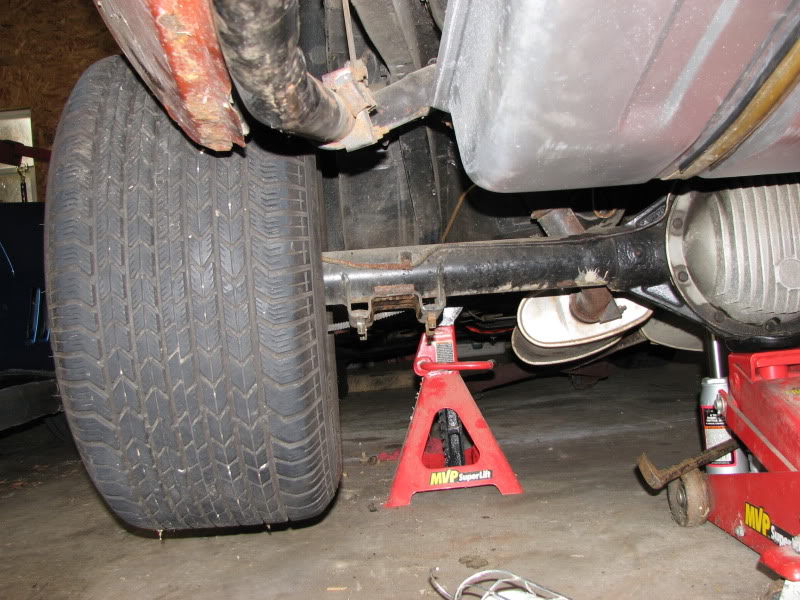

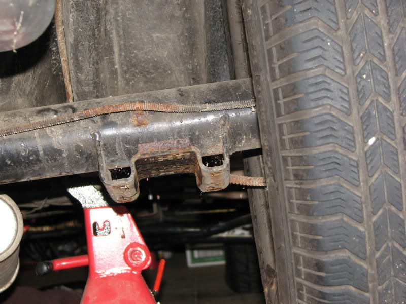

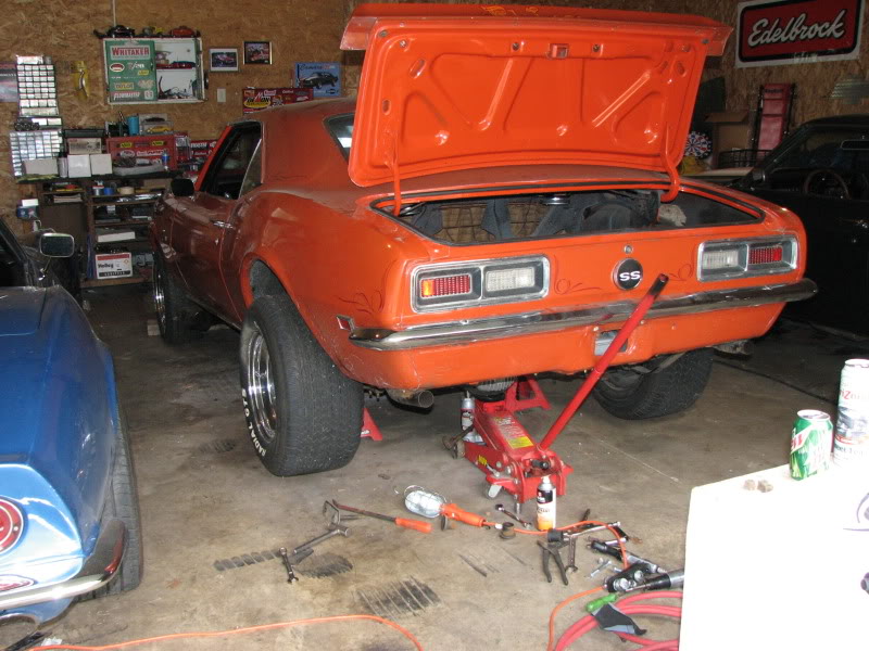

i jacked the car up by the pumpkin and rested it on jack stands on rear frame rails then used the floor jack to support the rearend while changing one spring at a time.
