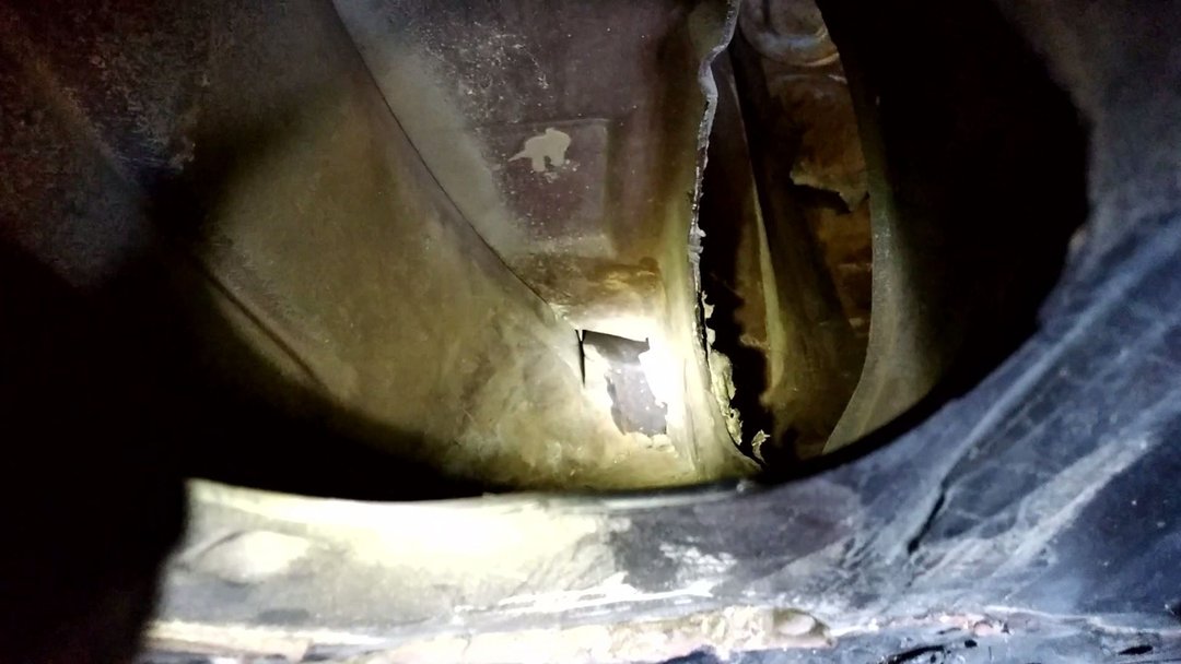

For those who are reading this forum chain, I checked and these bolts can only be accessed via the kick panel access hole on the driver side. The passenger side can be accessed by kick panel or the fire wall at the heater core/fan panel opening. They are completely hidden from view but and (with small arms) you might be able to feel the bolt. Like mentioned above, you can use a 1/4" tube extension on the spray lubricant and get down deep in the panel just in front of the rocker arm. I've attached a picture looking into the fire wall hole where the blower fan and heater core cover is mounted. You can see the dark area in the pick that has the lubricant. This is also a good area that should be checked out for rust. Lots of debris and dirt can plug up the drain hole at the bottom and water can collect in this panel. I got lucky and the interior of my car looks good.
