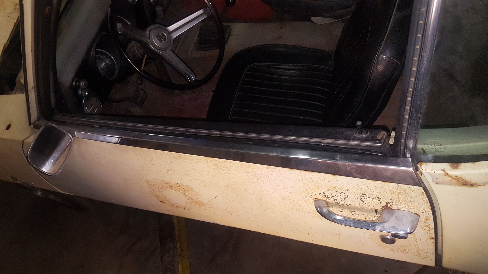

Here is a photo can you tell which I have?
Old Sep 2, 2020 | 10:13 AM
Everett#2390's Avatar
Joined: Oct 2012
Posts: 2,595
From: Va. Beach, VA
You have Wide Chrome.
