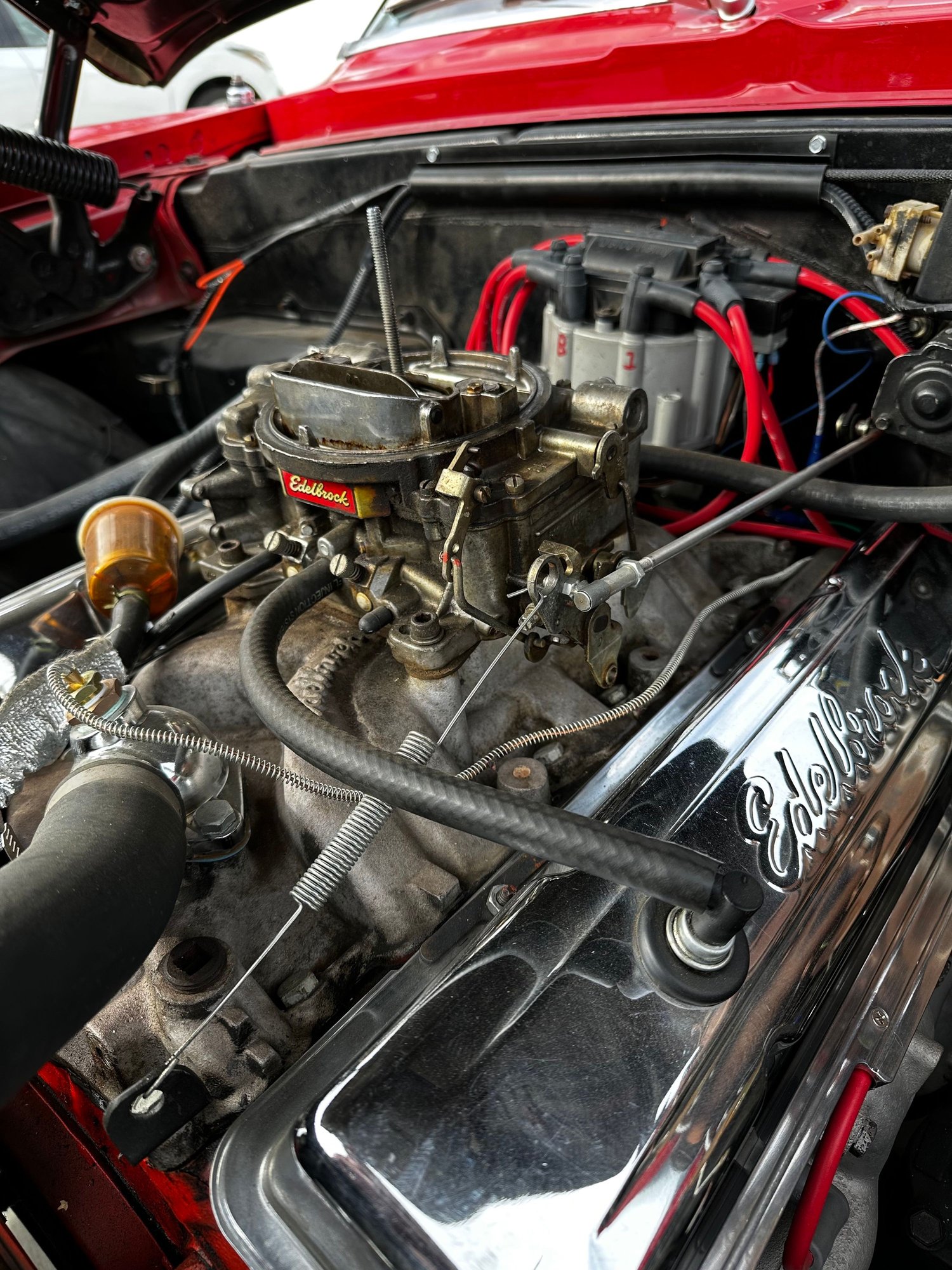

Here is the picture i've been meaning to take, sorry for the delay. While I have cleaned the carb linkage it certainly does not seem like it in the picture. Maybe you can suggest what else to use other than CarbCleaner (I used Gumout carb and choke cleaner).
carb return spring location - not sure if that is the right spring either.

Your return spring is a way of doing it but typically it is from the rear of motor like in my pic in post 4

I knew it looked odd (long spring) I don't think I have a bracket at the rear of the manifold to attach the spring to. I'll see whats out there, as there has to be a simple one since I have HEI I don't have the conventional coil mounted on the manifold.
stay tuned for final pictures.

Thanks for the picture 1stGen. I ordered a bracket with a double spring and will most likely end up looking like your set up. I too agree that if the solution is working then it is a solution and not a "rigging". How it's set up today does work but I am speculating that somehow the spring is either not strong enough or that it is not mounted at the proper angle to return the throttle. The end game here is always the same, want to enjoy the car and not have to either rebuild or replace the carb. Mine as I just found out is an Eddy 1407 which makes it a 750cfm. I was a little surprised that it was that big. I will keep that in mind once I get this resolved. I don't believe its over carburated but the last time I had a carb that big I was running a 30/30 duntov cam in an LT1 with 11/1 compression back in the 80's and that car was more powerful than this one. In the end, if I end up deciding to keep her after this year I may just fo EFI to simplify things.

the stock return spring attaches to the bracket that holds coil. If not using the coil position, a simple metal tab with hole using the bolt hole for coil would work
IMHO, just a cleaner look but as far as a return spring "working", it will be fine if attached to front of intake in some fashion
