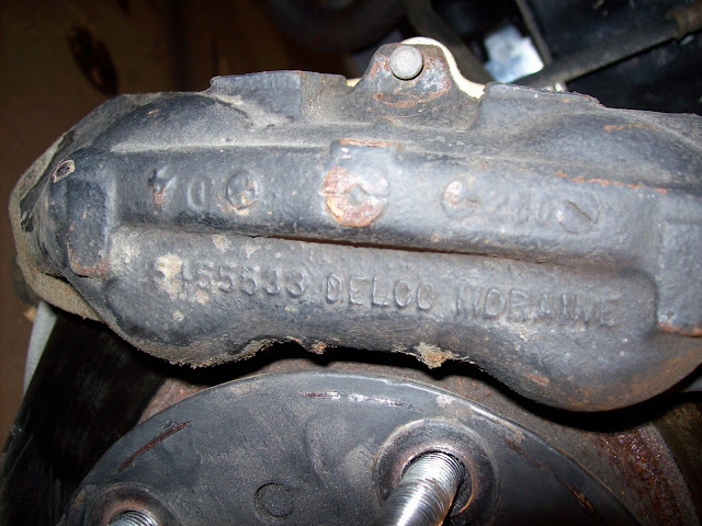

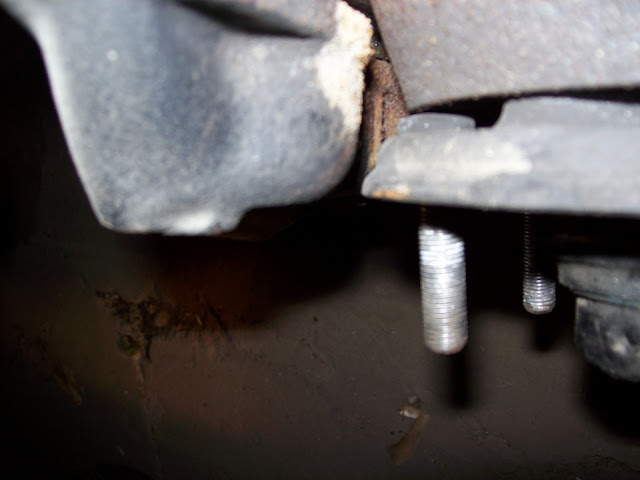

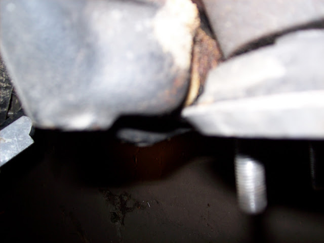

I was able to take some pictures of my brake rotor and caliper to see if this helps with any questions.
You can see that the brake rotor sticks out from the wheel hub.
Even after adding a spacer plate, it's still not enough to clear the caliper.
I looked up the casting number and it appear to be from a 68 Camaro as I mentioned above.
From what I could find, the brake rotors are the same from 68 to 69, so I'm not sure why the caliper sticks out so far. The guy I bought it from was not very mechanical, but drag raced it, so anything could have been done to it. I am getting the feeling that they put brakes on it from a 68 to get better stopping power. Is there anything else that should be from a 68?

What diameter wheels do you have, 14" or 15"? Stock or aftermarket wheels? 14's could cause some clearance issues, but generally at the outer edge of the caliper. I've never needed to compare between the 14's and 15's, so I can't say if there might be a difference in how they step down on the back side at the hub area.

I have 14" aftermarket rims. They have no offset from the mounting. They are a Cragar look-a-like.
Do you have the single piston calipers on you 69? Does the caliper stick out from the wheel hub like mine?
Old May 18, 2010 | 09:07 AM
I still have drums in the front, conversion somewhere on the horizon. I do have disc in the back, from when the Ford 9" was built up. They work surprisingly well that way, but probably wouldn't if the back tires were stock skinny's.
