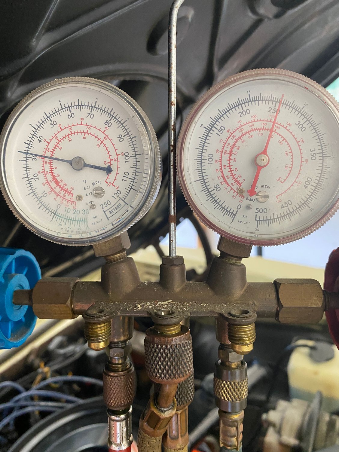

New to the group and my 68 RS convertible.
Factory air previously converted to 134a wouldn’t cool but a few degrees so switched it back to R12.
Now going down the road temp fluctuates from low of 62 to high of 72 and back again.
Low side pressure at 30 and high side 250.
Used to be AC tech 30 years ago so know enough to be dangerous but not enough to fix this problem.
Heater core disconnected.
I am in FL so please don’t say just put the top down lol!
Pressures
Pressures

OH chit
40 year AC service tech myself and a Ford chassis master but hell
Can't really switch back unless you replace every component
Looks like you got it flushed out good enough, and must have a supply of R12 like me
However
Just replace the capillary tube / expansion valve and try it again
Your orifice is the problem and switching the oils twice probably did not help
Capillary tube / expansion valve was most likely the fault all along
Pressures look good / perfect
