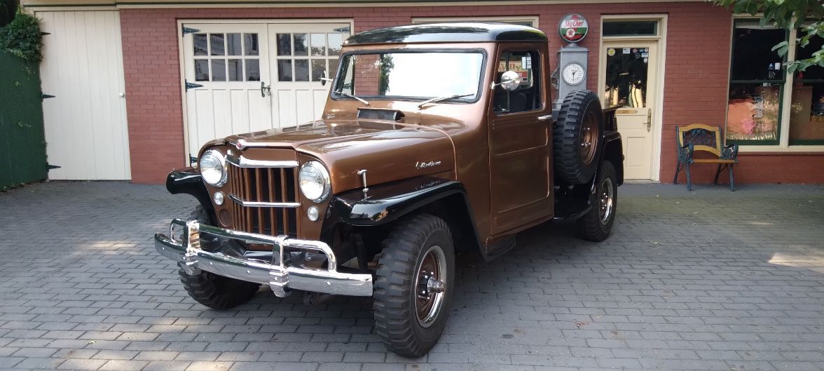

I have restored 24 ****** jeeps 42 to 62 1st thing I do is take off all the huge tires that cause death wobble. LOL I dont necessarily go back to stock but I take 16x 12 to maybe 15 by10s or 30 from 36's. Cool truck. I build all these off road vehicles and I never go off road! I sell them before I destroy them! attached my most recent from a pile of rust!
