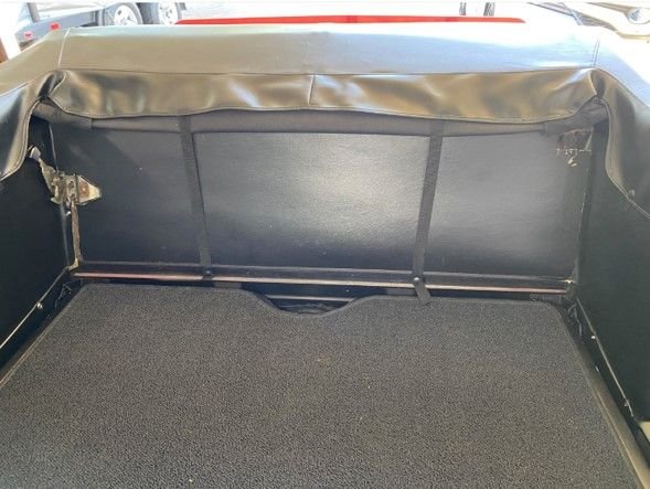

I also had some frustrations with the boot cover on my 68 Camaro.
-The
wind tried to remove the boot as it did not tuck in sufficiently behind the seat.
-I solved this by sewing 1” wide straps into the boot and adding two snaps (see Pic). I know the strap is not perfectly straight as I had to move the snap a bit at the bottom to miss a wire, but it is all hidden with the seat up.

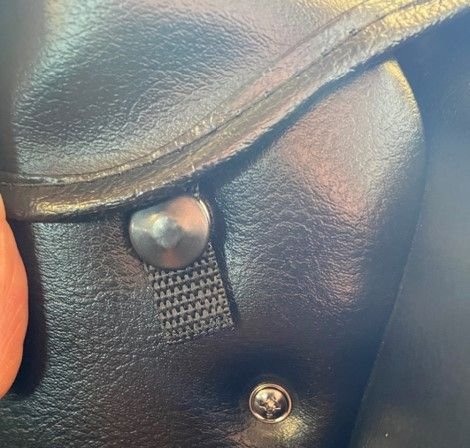

-I
also extended theside panel snaps by sewingashort pieceof1/2”webbing to give me the 1” or so to reach the snap previously installed on the side panel. I did this to avoid a second hole in the panel. The black snaps are from eBay.

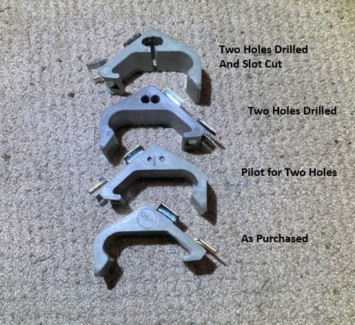

The boot clips were a more painful problem as the stock clips were extremely tight on the chrome window trim and I was afraid removing the clip would tear the trim off the car.
-I
solved this bydrillingholes intotheclip & adding a slot (see pics) this relieved much of the tension on the clip and allows easy attachment and removal. It took a couple of hours to do all the clips but I’m happy. I used a Dremel “spiral cutter” to connect the drill holes which was easier than using a drill bit.
Ihope this helps, letme know ifyou have anyquestions.
