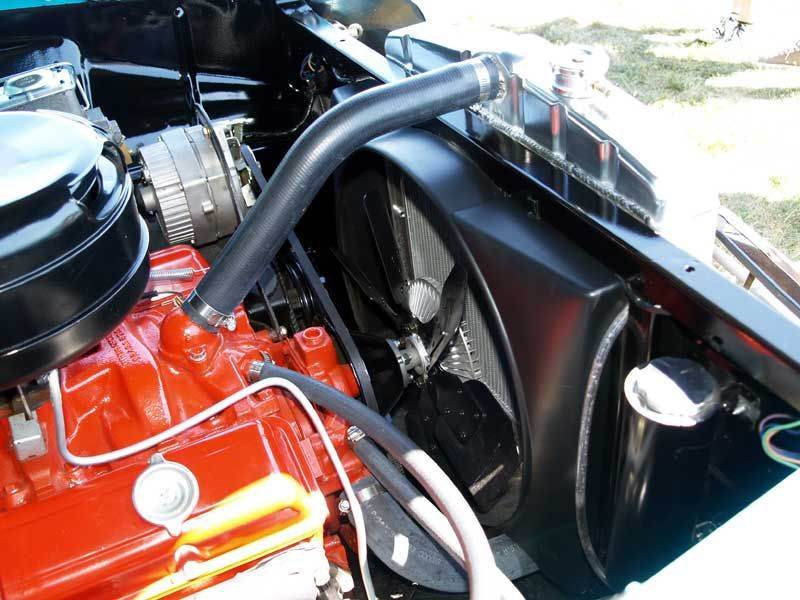

Here is a picture showing a stock set up like I suggested with a clutch type fan,the shroud is the big plastic piece attached to the radiator that the fan is inside of.
Old Jul 7, 2019 | 02:57 PM
As you can see here,most of the air has to be drawn through the radiator rather than from around it. The shroud is an important piece.
