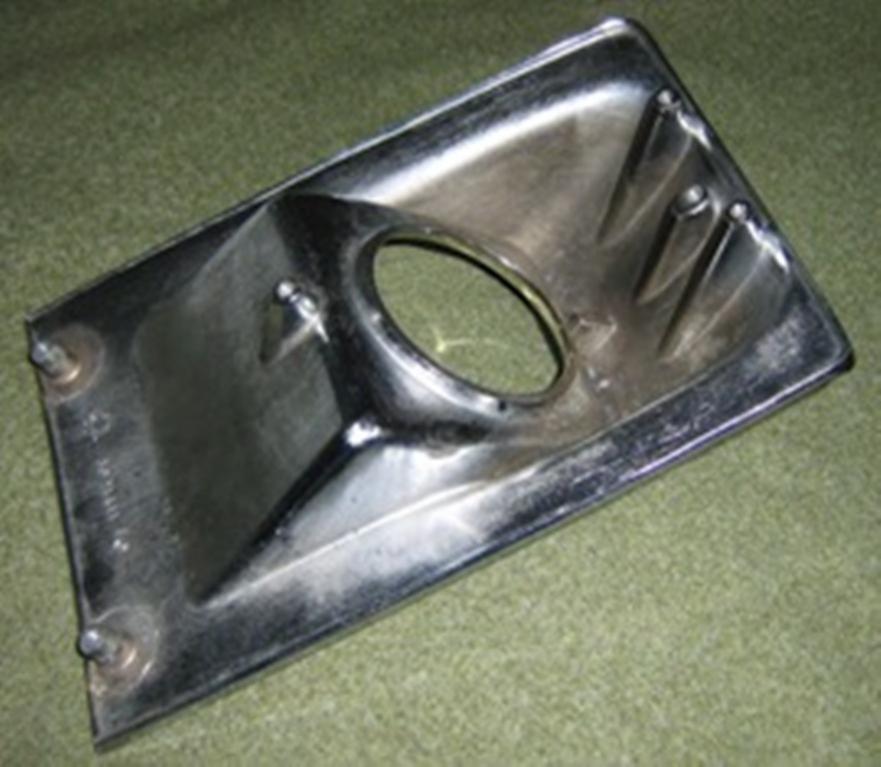

I have a center console with a clock installed, need help. Clock is dated 1967, and is installed in the pot metal mount with casting number below
3921411
This is mounted in a 68-69 Center Console between seats. My issue is the clock will run and keep good time until I mount it in the Console, it then still runs but the minute hand and hour hand will stop, but the second hand will keep moving as it should.
This is a recent quartz conversion, and as I mentioned it keeps perfect time on the bench until mounted in the Console.
With the casting number listed above and the clock dated 1967, is this the correct mounting unit? It appears that the Clock does not seat correctly into the pot metal bezel, and I am wondering if this is the problem.

The Clock and the Mount are right here on my bench and the clock does mount in the console the same way as it does on the bench.
There is a tab at the 12 o'clock & another at 6 o'clock, and it faces up at about a 60 degree angle.

Well gave it another try and got 4 pics of the Clock & Mount in my album

There is plenty of clearance between both hands. Also I have the mounting plate here on my bench and with the clock mounted it rund for awhile then same thing happens.
I am wondering if the lens is to thick and is pushing down on the clock when mounted in the plate. The lens has a couple of notches in it and they are moulded that way, but am wondering if its the right lens for the clock.

Don't know the thickness. So the clock (as we see it in the picture) will keep time, or are you taking it apart? And the two hands won't stop until you mount the clock to the plate? Does it feel like it takes some force to get the clock scrwede down to the console plate? Something may be tweaking and binding from some force being put on the body or face of the clock.

3 Attachment(s)
Attachment 4743
Attachment 4744
Attachment 4745
When the clock itself is totally assembled it keeps perfect time. When it is mounted into the plate it runs for a little then the minute hand & hour hand stop, the second hand keeps moving as normal.
As for puting pressure on screwing it to the mounting plate, well its not that much, almost feels like normal. then I'm thinking the lens is a little to thick therefore puting pressure on the movement. But its not stoping the second hand, and its closest to the lens.
There is some thing that is in the mounting that is as you mentioned tweaked or applying pressure.:icon_shrug:
