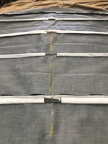

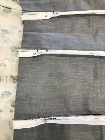

Laid out liner and found center
Cut around center where clip is
Dry it with some pinch weld from local shop (15' for $35)
Stretched front and back (dry fit) used hair dryer to work out wrinkles..... worked surprising well!!
Dry fit sides and keep working on wrinkles. *Also needed to snip material in front of the rods to stop material from bunching up. Once most of the wrinkles were out I glued and stretched ans fastened the liner in the channels.

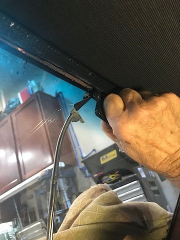

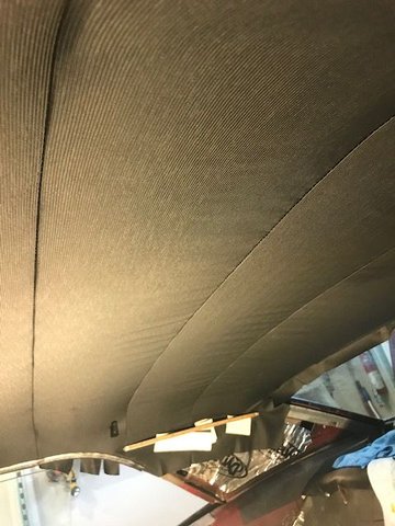

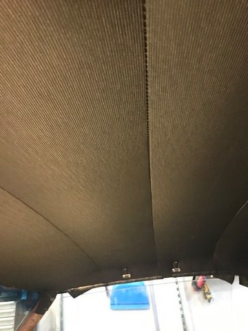

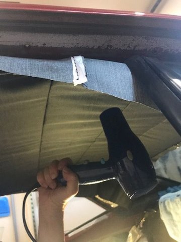

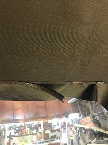

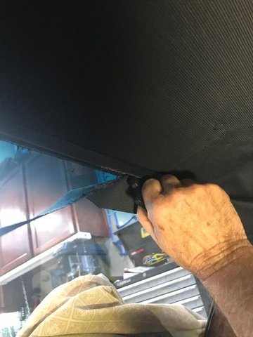

Here are some random pictures of the headliner install. I took me about 6 hours to do the job once I had it ready to put in.
First, I put a small space heater in the car and rolled up the windows. It was about 50 degrees in the garage.
Stared by clipping in the liner in the center clips.
*** Put the screws back in on the mirror, rear view, seat belt clips, coat hanger.... to find the holes later****
With the car warm, the liner stretched easily.
Dry fitted the front. Started retaining in the center... worked to the left, pulling forward and left.... then pulled to the left. I borrowed the boss (wife) to pull to the sides so I could set the pinch weld with both hands.
Repeated this in the back window.
Used a hair dryer to work out the wrinkles (used the boss for that also while I kept stretching.)
After the wrinkles were under control .... took the deep breath and applied the Permatex weather sipping glue. Used a Popsicle stick to spread it.
I did the same process as the dry fit. A little tricky in the corners.....take your time when snipping the material ... you can't un- cut the material. (my biggest fear..) It worked out really well actually no boo boo's
The last picture shows a few wrinkles in the material, but I have not used the hair dryer on that part yet. * in the video, he said that they would work out on their own... but I will keep at it.
