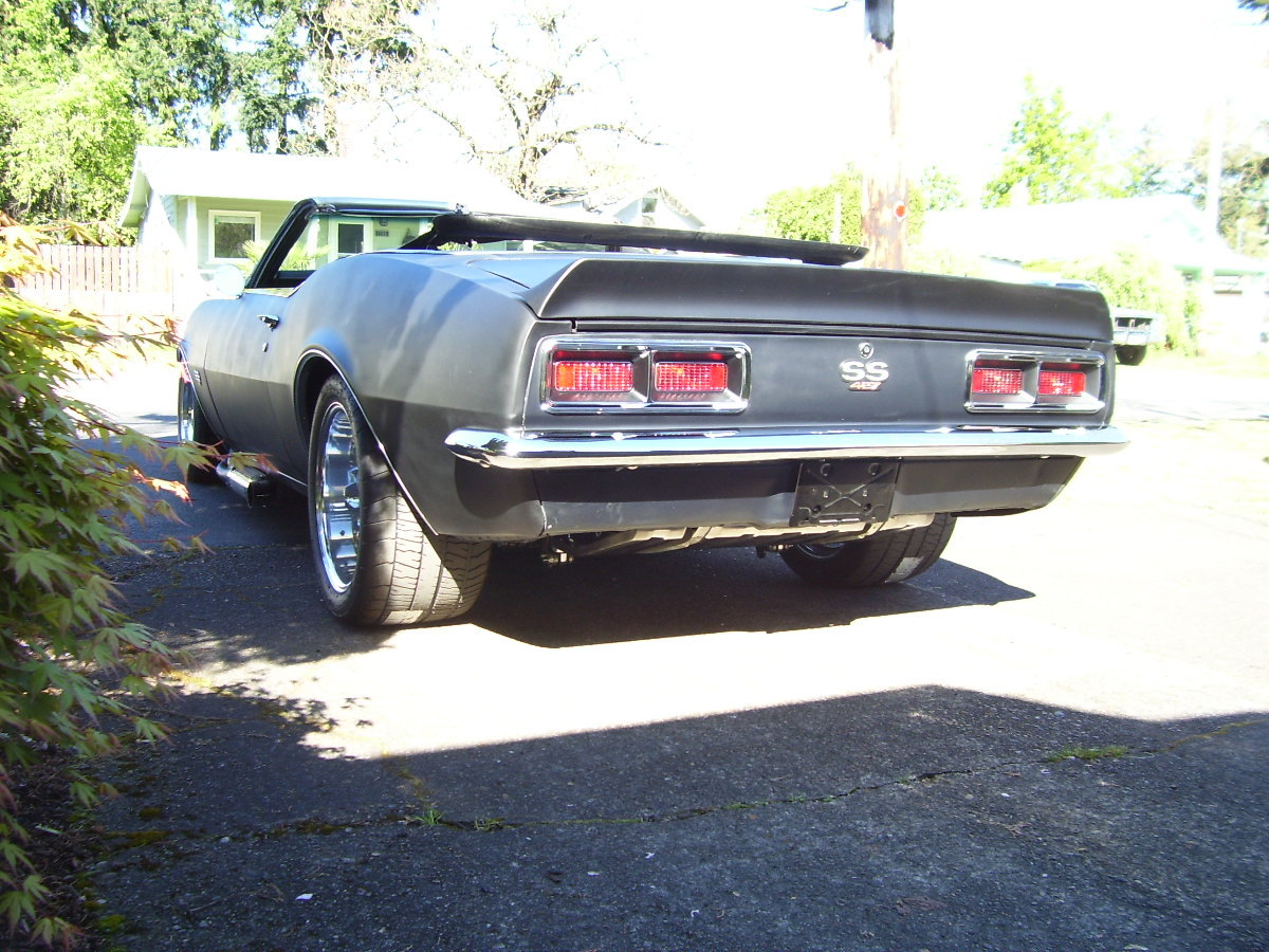

Long time since any updates. Mainly because my buddy has been shooting paint, and it's finally done. Not my idea of what I like, but it certainly does look sinister in satin black!
Today we hung all the chrome and stainless trim on it. Mounted the trunk lid, hood, doors, grille, taillights, wheelwell moldings, bumpers, and badging. He got SS 427 badges for front, back and front fenders, so not doubt what it is. He had a cowl induction hood modified by cutting the hood vent section out of a donor hood, and had them welded into the cowl section of his hood. The chrome factory vents on a cowl hood look very unique, and like something Chevy should have done!
We had one heck of a time with the aftermarket outer door handles. The stock door handles are 1/8" longer spacing between the two mounting screws than the new repros. We had to use a jeweler's file to open the holes slightly towards each other and get them to fit. Similar issues with bumpers, and had to work the brackets a bit to get everything to line up, and sit properly on the body.
Just need to install the interior now, and it's a done deal! I'll let him do that part, unless he runs into problems.
