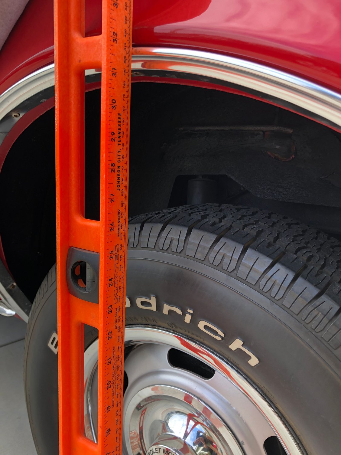

I just went out and measured from the ground to the lip of the wheelwell trim and it is 31", which is deffinitely too high. Now I am wondering if the leaf springs are the right ones?

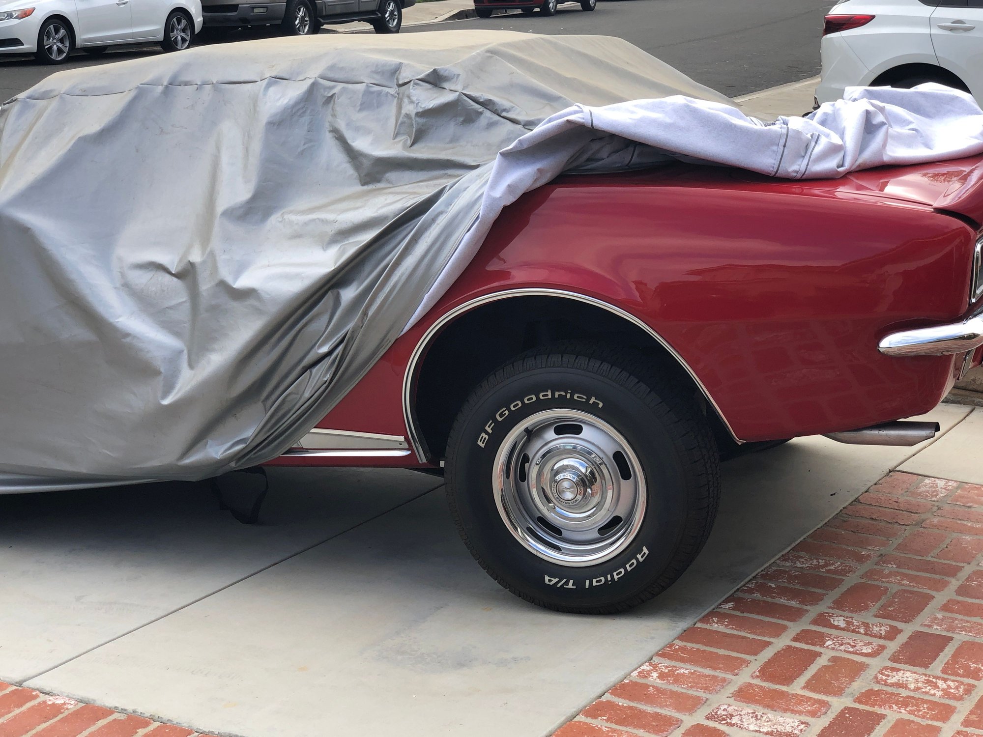

Old Oct 15, 2022 | 10:33 PM
2er0brd's Avatar
Joined: Aug 2021
Posts: 60
From: California
here are the pictures of it on the driveway.
Taking it Tuesday to put back the old leaf springs with new bushings.
I loosened up the shackles and tried to bounce the car but the new shocks and springs did not make it easy to bounce it. Either case I tried for 10 min and while I did get some motion on the car (even by sitting on the bumper and edge of the trunk) it did not make any difference at all.
