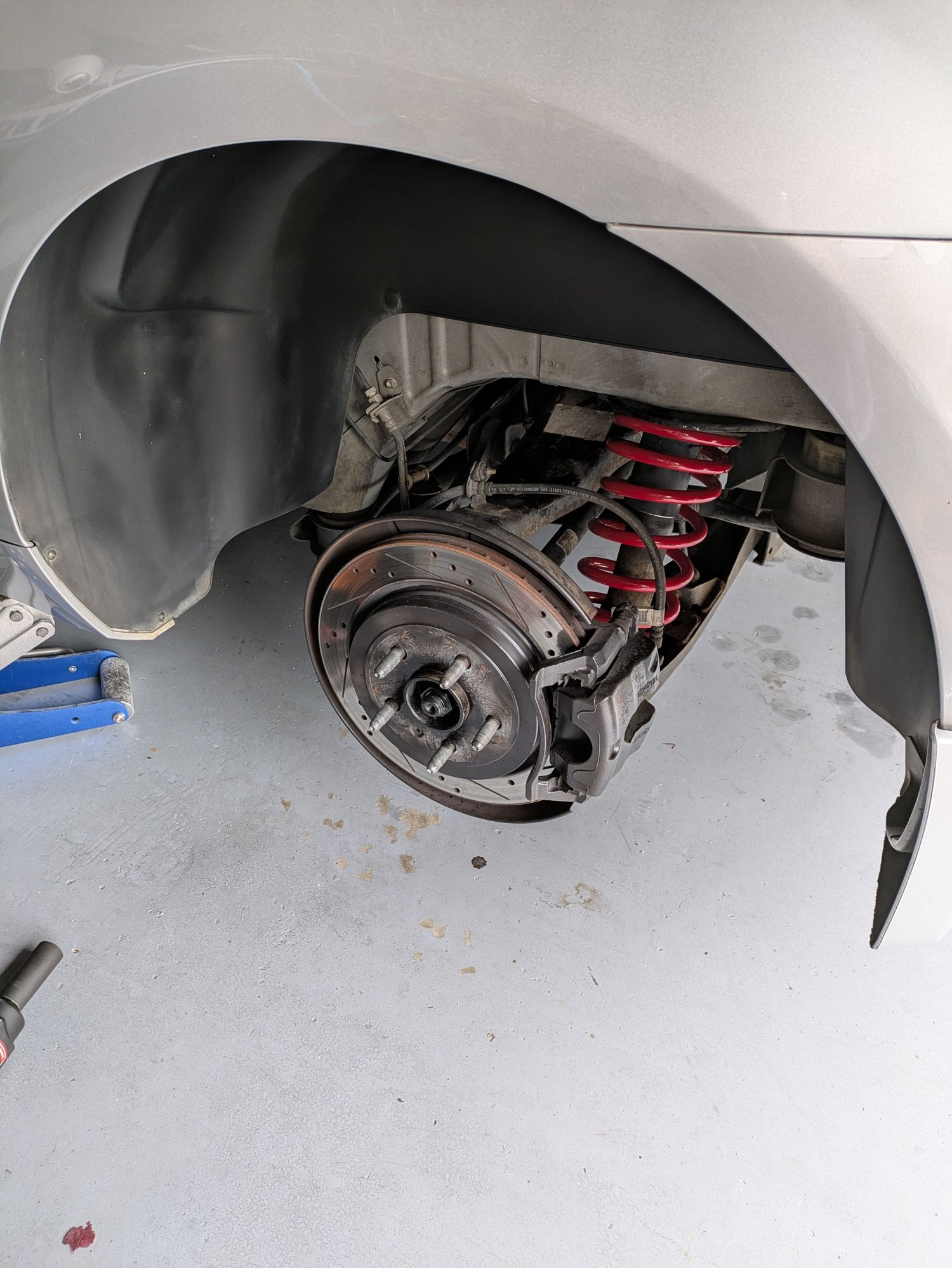

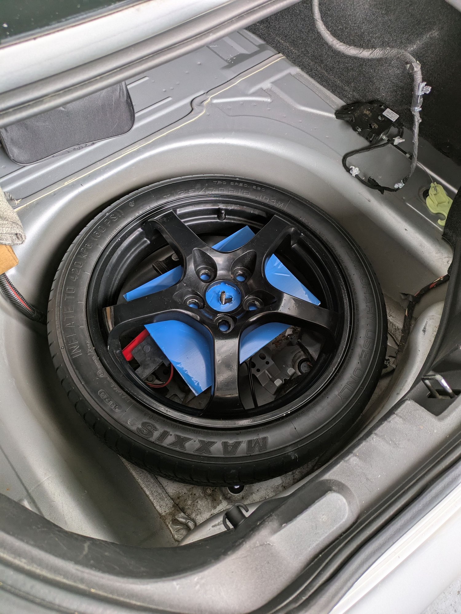

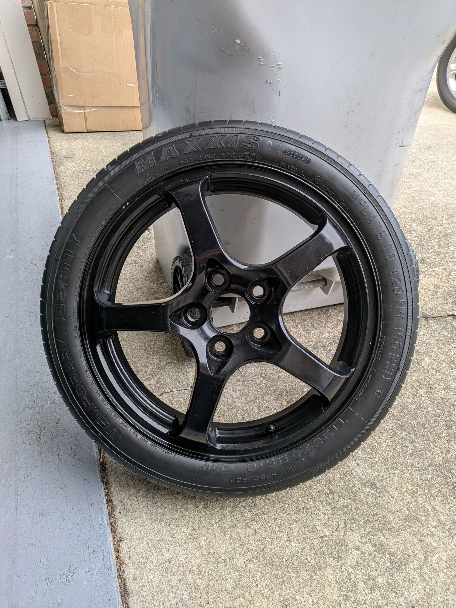

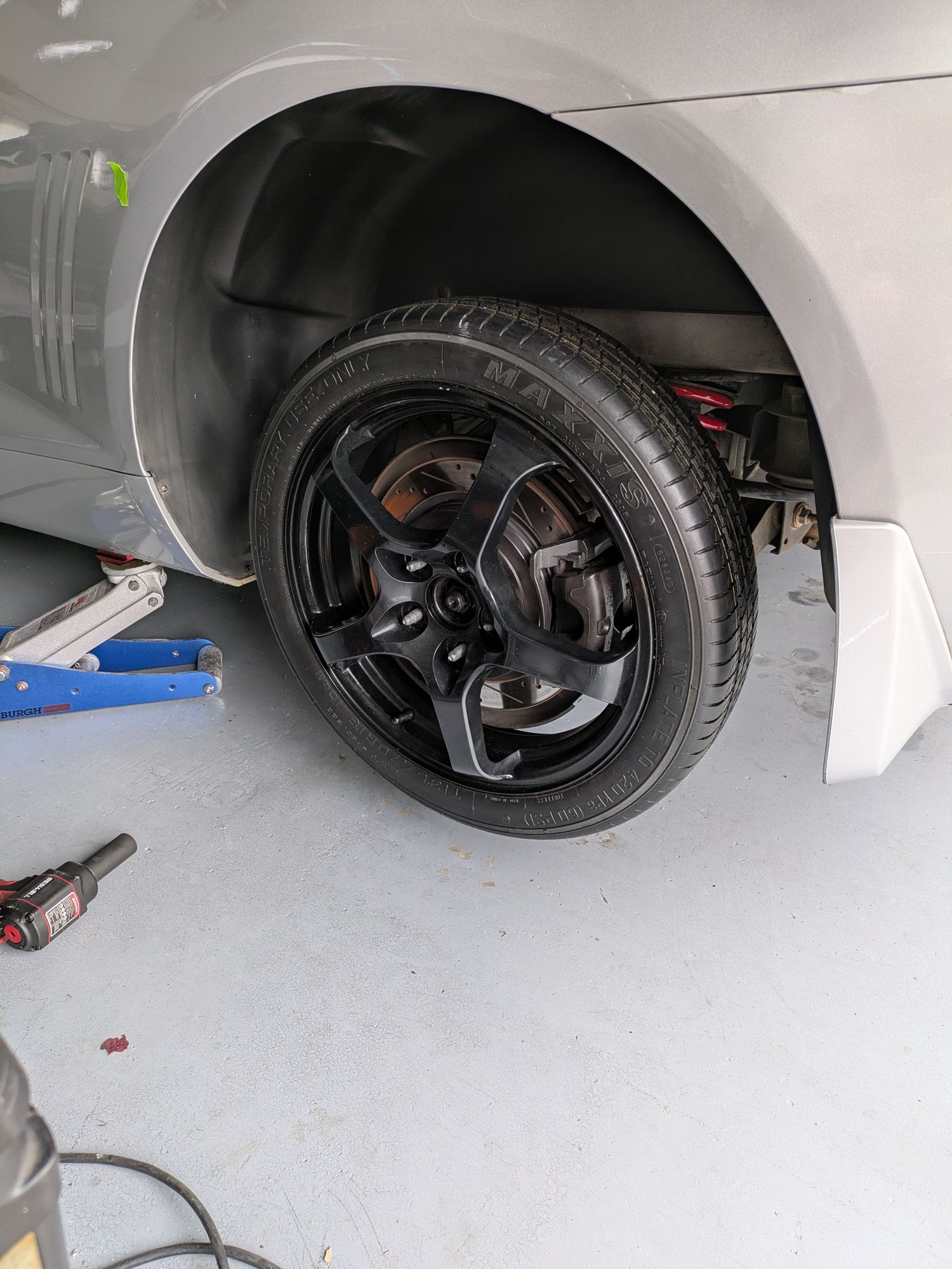

Just ordered one of these for my 2011... https://www.ebay.com/itm/256421909315 Don't care about widths of tires as it will just be for emergencies/short term. Hoping it will clear all components.
Edit: The compact spare from a Cadillac does indeed work well. The only annoyance is the wheel design is slightly taller when stowed in the spare well...I can live with that vs having no spare at all.
