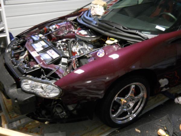

DSCN0066 fenders splash guards,hood fits ? the holes are not in the same place on hinges so modify the holes an trim about 3mm ,couse the glass good is 3.5 mm thicker ,then add from bumper to come fenders line up fine the plastic is hard to work worth .so all coversions will be different
