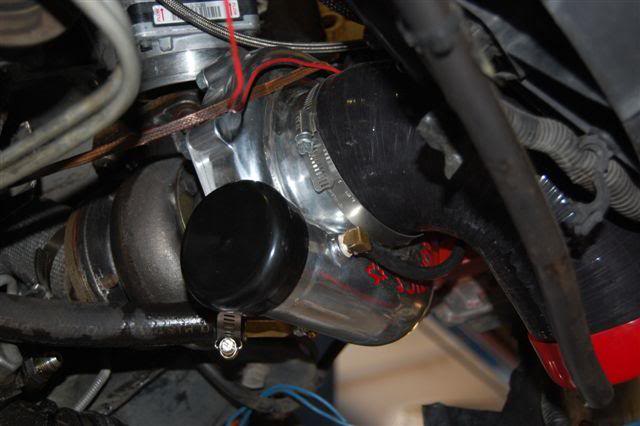

What size turbo are you planing to run. Tons of guys are running twin 60s and even twin T72s on both LT1 and LS1 4th gens so i dont know why you would want to cut the hood to run one. There is tons of room up front between the motor and core support where most guys run theirs. You can move the radiator forward and more upright to make room for it. TTI also makes kits for the LT1 and LS1 along with a few other companies that keep the factory AC.
I ran a turbonetics T76 on the divers side of the car mounted under the power steering pump. The T76 was a very tight fit in there but before that i ran a 60 trim on a .96 A/R that fit with no problem.

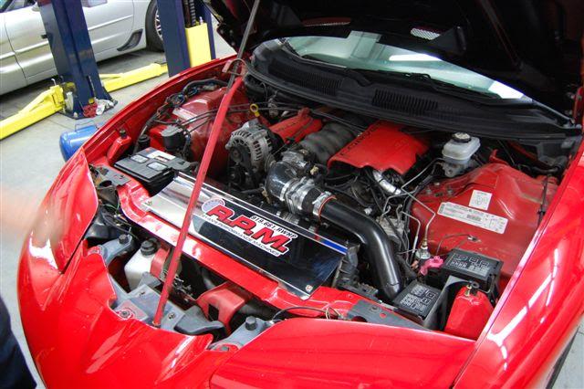

I'm thinking of mounting my t76 high, and cut a hole for it in the hood so it would stick out, to gain some more room in the bay for piping and most importantly for the a/c compressor. (because the bay is without an engine or piping for the turbo for now i can't judge how much room i'll have)
My question is : would that be as doable as i think it is? And will it really make that much difference room wise?
What about oil supply for the turbo? Will it be affected?
Thanks alot
Ps: if you guys have any pics, that would be awesome! Cheers

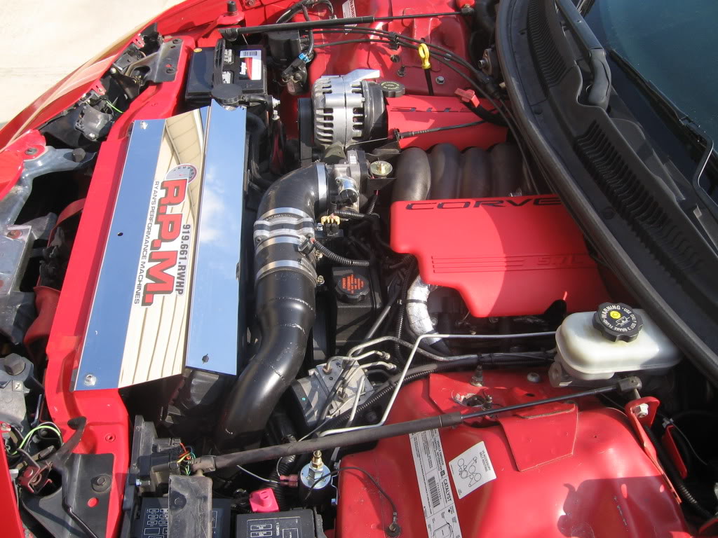

First set up with 60 trim with smaller intercooler and 60 trim

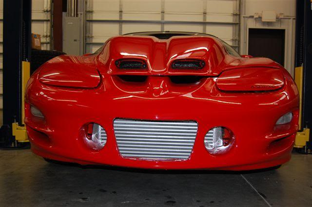

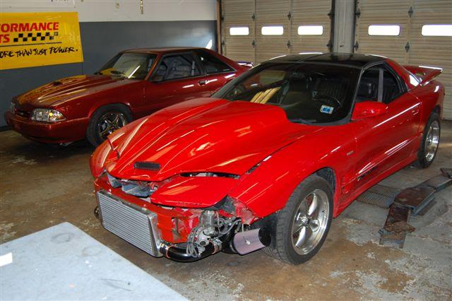

Second set up with bigger front mount intercooler https://camaroforums.com/forum/newre...ply&t=62252and T76
Why are you trying to run a T76 to start with. I dont know what kind of motor you are running but a 62 would be a lot more responsive and is a little bit smaller if your worried about room. I am a big supporter of not running any more turbo then you need. This helps get the most out of your set up and too get the power to the ground faster. Running even a 72 on any thing other then a forged bottom end with a good set of heads and decent cam is going to be a waste of time.
A T76 can support over 700 horse power on our cars. I dont know if you have a LT or a LS but the LS1 which responds very well to boost and has a great PCM for tuning boost hits its limit in the high 400s. After that its just not going to live very long.

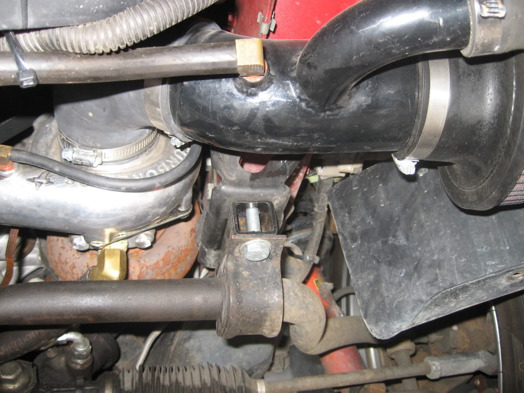

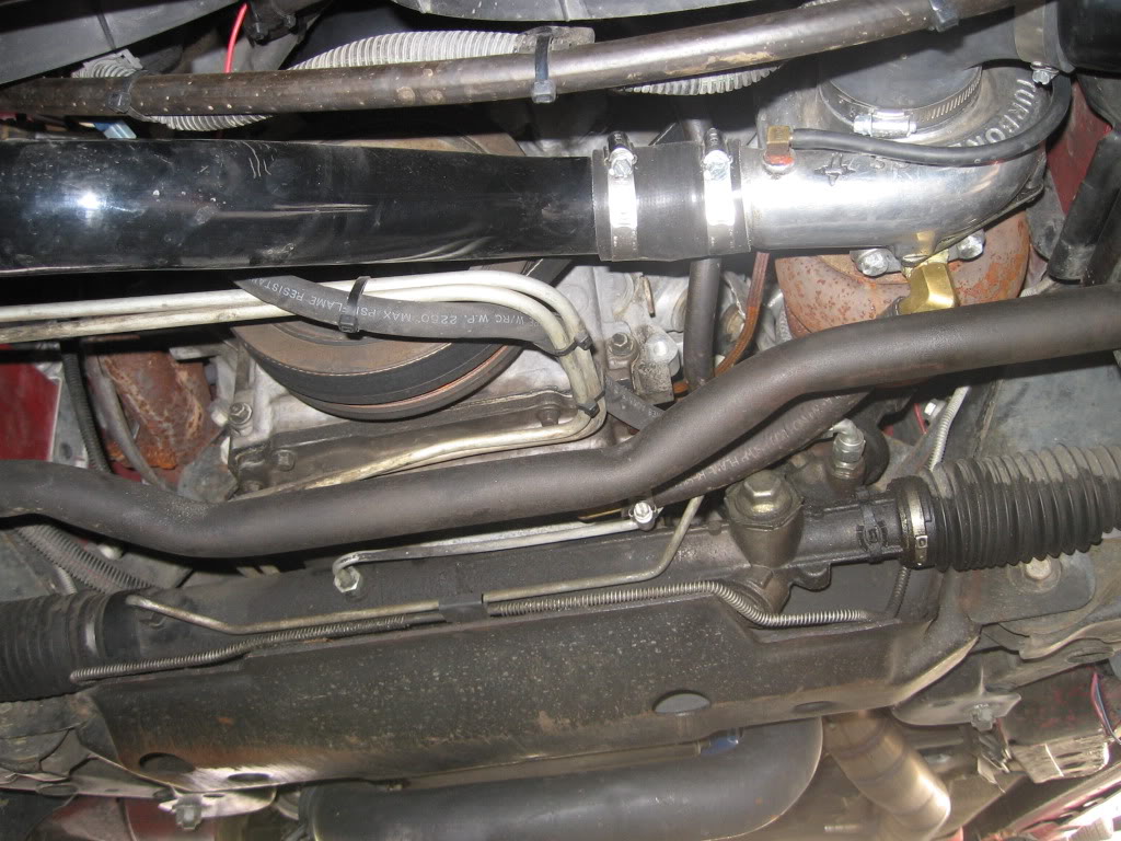

 who cares if it lives for long, i'm about done with the build, i went with the turbo mounted between the core and engine, lots of room there, i'm gonna have to run some different fans though, the only problem i encounterd was where to route the down pipe, so i made it exit just infront of the left front tire, there will be alot of right ear damage to ppl who race me but i can live with that 

Thanks alot for the pics and advice, i'm doing my project after seeing a couple of camaros here that have the same set up, but without the a/c both making 500+whp on bone stock engines, one for more than a year now....
