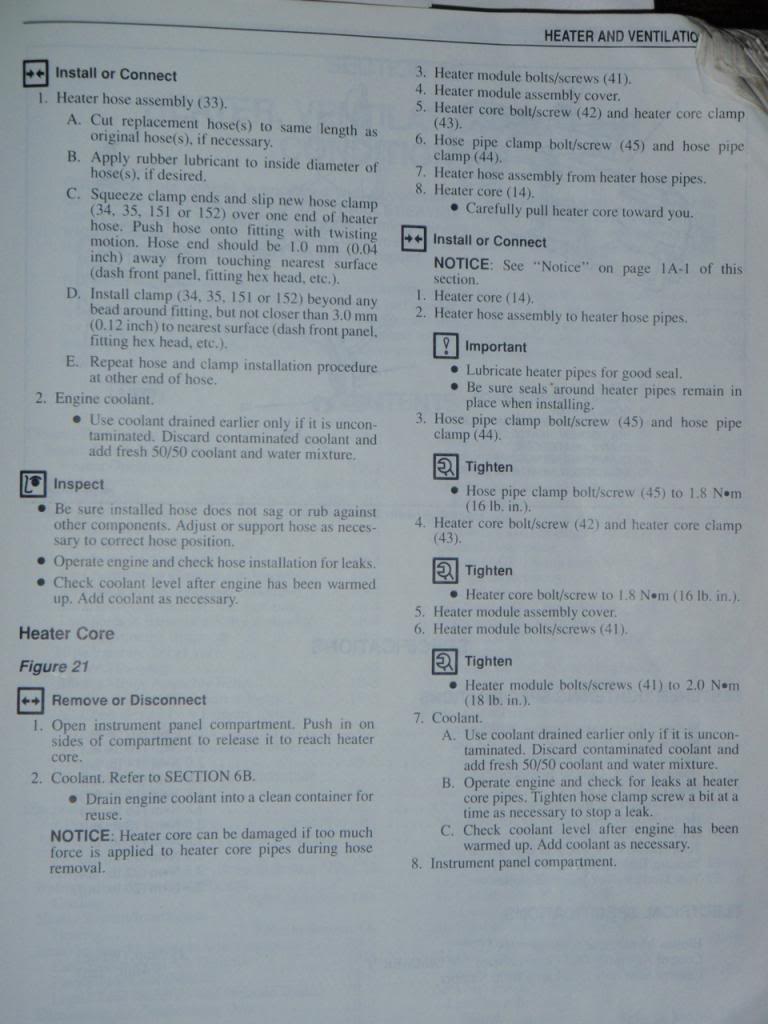

craby Mar 1, 2013 05:50 PM
How to remove heater core Lt1
4 Attachment(s)
will be linked to in the how to and faq sticky. add info if you have it.
Attachment 15973
Attachment 15974
Attachment 15975
Attachment 15976
