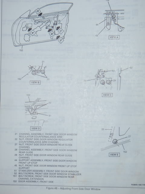

BasicConcepts Jul 15, 2011 01:11 AM
http://i34.photobucket.com/albums/d1...s/IMAG0188.jpg
ok so the green circles (and arrow) are bolts that hold in the tracks these come out... the far right circle is a stop for the glass theres a piece on the inside of the door (mark this you dont want it to move)
the yellow circles are to pull the mirror
the blue circles space the window those come off (mark these)
the black circle is also a stop and again theres a piece inside the rail (mark this too)
the orange circle shows where the motor is
and the red circles are the rivets that have to be drilled out
theres also 3 rivets that hold a track to the glass i recommend drilling those out after you get the glass out this makes it much easier to get it back in then bolt the rail back on after
hope this helps should take anywhere from 30 min to an hr to do depending on your abilities
