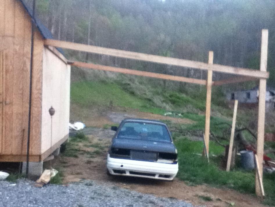

Good news, I am now building my garage, will post pics as the build goes on! Remember, This will be built by just 2 people, its 16ft wide, 24ft long, its going to make my other building look like a midget, and its 12x16 I dont know how high I'm going to make it, I know it WILL have a lift in it, Eventually.
Old Apr 17, 2011 | 08:03 PM
  #69
iCrossbone's Avatar
Joined: Mar 2011
Posts: 105
Day 1:
That is only half length, Width is setup. That was so troublesome to put up because of the wind and the short of hands.

Hi iCrossbone,
It's honorable that your building your own garage. I used to build pole barns 20 years ago (they're pretty simple) and off the bat, if you don't mind I have a couple of concerns with what I'm seeing in the picture you posted.
It looks like your existing roof must be around an 18/12 pitch and your new roof will be about a 3/12 pitch. You won't get much runoff with that low of a pitch and most shingles want a minimum of a 4/12 pitch unless you pan on roofing with tar or torch down. Assuming you get snow, your going to have a very, very heavy load of snow that's going to get caught on the lower roof due to the extreme transition.
Also it seems a bit far to be spanning with a 2x6's unless you plan on going 1 foot on center (I'm assuming you get snow where you live?) Also, your header should be a min of 2x12 and should be nailed and bolted to the posts, as well as another header that should be nailed and bolted to your existing garage (again, it looks like your using 2x6's? and you could use some extra support under that header so it's not relying soley on your garage wall.). Your gables should be flush with the end of your posts and nailed to your posts, and you'll need about a foot of over hang for soffit.
I'm assuming also that you'll be using joist hangers for your roof that will be going from the support header on your existing garage to the header across your poles?
I hope you don't take my criticism the wrong way. It's exciting to build your own garage so for what it's worth, .02
