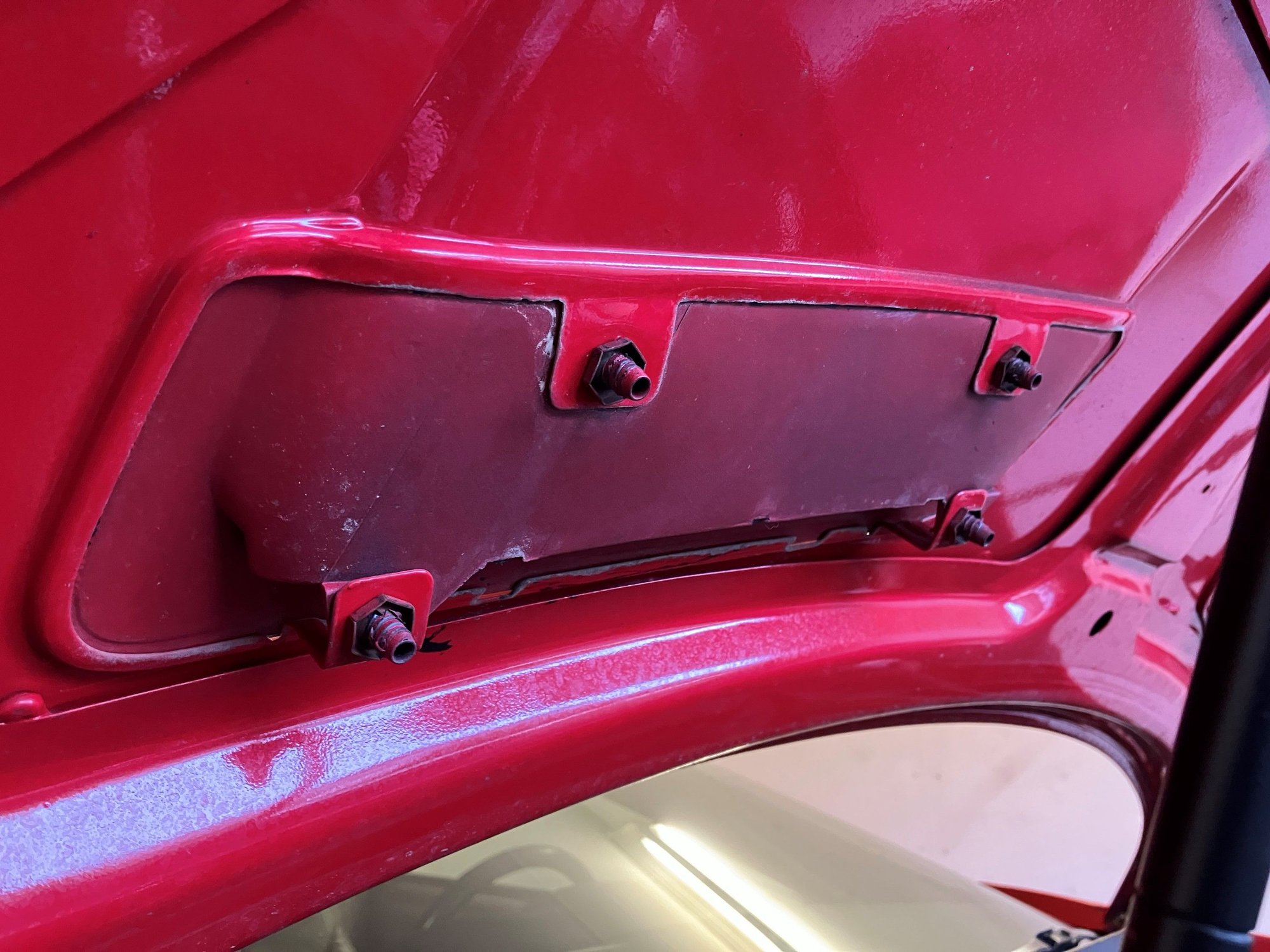

On a side note, these hood inserts were not installed when I got the car and I'm not sure exactly how they are supposed to be secured. I'd appreciate any insight on this. It almost looks like there are larger coarse threaded nuts that go onto the posts?
Old Dec 9, 2025 | 02:15 AM
Posts: 22,001
I think they are them thin metal nuts. maybe check in the parts manual. go here https://www.mediafire.com/?40mfgeoe4ctti parts manual at the bottom.

Robroy Z28's Avatar
Joined: Sep 2024
Posts: 140
From: South Sweden near Copenhagen
Snapped a photo for you, my car has been repainted so not sure how accurate they got reinstalled...

ChaseA1989's Avatar
Joined: Oct 2025
Posts: 10
Thanks to both of you. Between the manual and the picture, I was able to find the part number. Appreciate it guys!

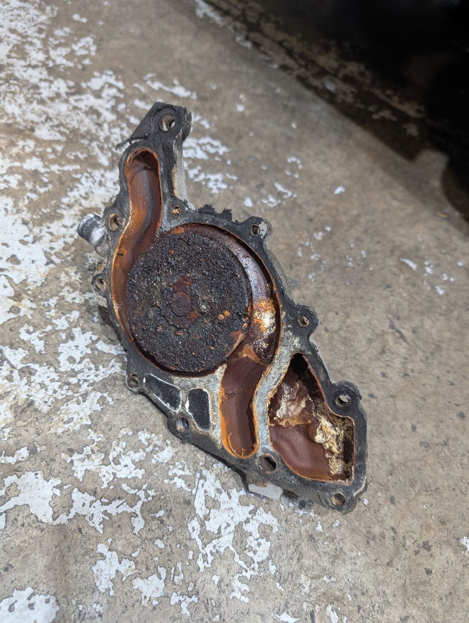

And the old water pump. It definitely needed to be replaced aside from the leaking.

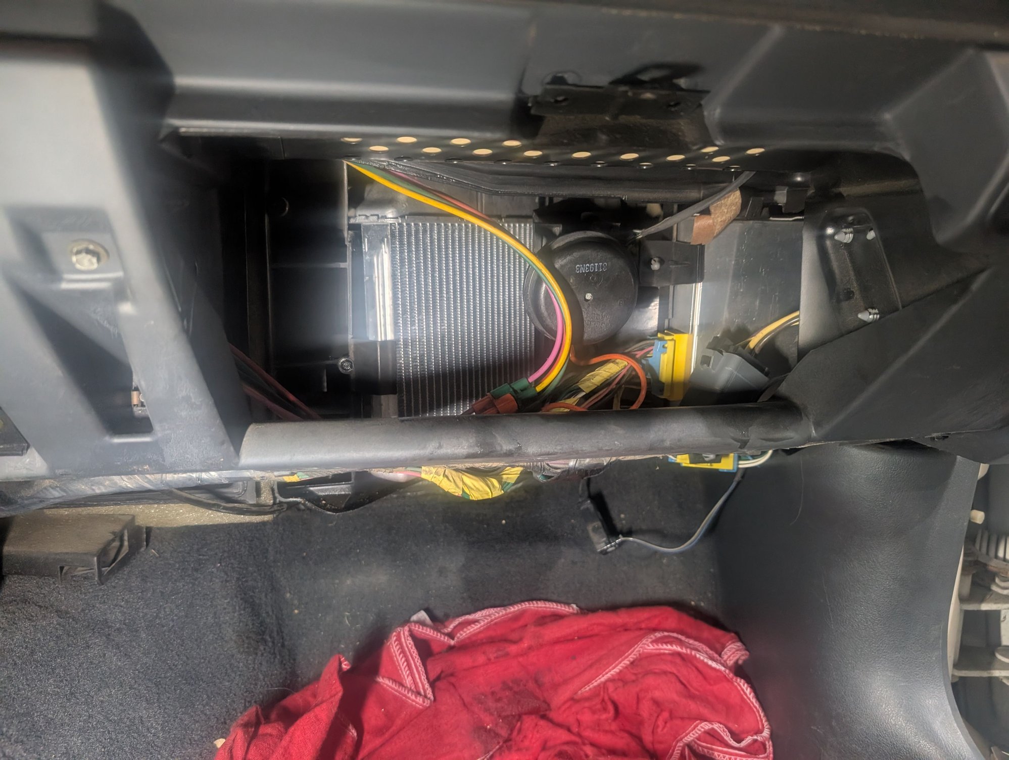

Also got the new heater core in, and fabricated some new heater hoses.
