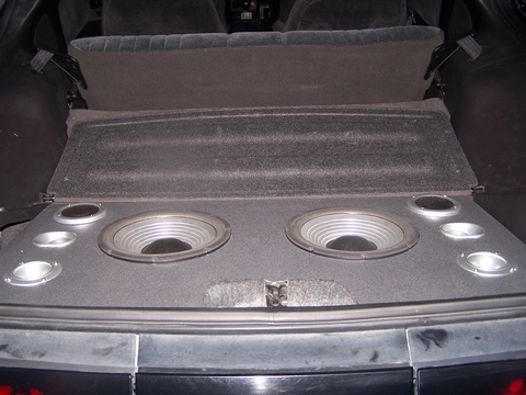

This is what I made for my Firebird. It's just a piece of 3/4" plywood, cut to the shape of the hatch, and painted with textured paint to match the carpeting. The section under it, which would hold the t-tops if you had them, acts as the "box". I have to say I'm really pleased with how it sounds. It can also easily be taken out if you do need to haul something. It may not be for everybody, but it works well for me, and people think it looks pretty cool.

yes but i have t-tops and id like to keep the trunk open for those
