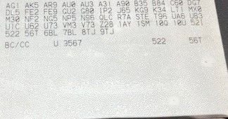

Oil change in the diff is on my todo list anyways, VIN decoder says I have a 3.42 rear axle ratio (RPO says GU2= 2.73 however, which seems accurate to the RPM) , guess that means the standard differential and not a limited slip?
craby Oct 22, 2024 11:21 AM
273 is normal for 6 cyl open differential is also stock for 6.
Robroy Z28 Oct 23, 2024 10:24 AM
Mine is a 8 cyl (just updated the vehicle descr in my profile)
2.73 makes perfect sense as I drive around idling if staying within the speed limits
craby Oct 24, 2024 09:31 AM
z28 will have a limited slip and most common diff is 3.23.
Robroy Z28 Oct 24, 2024 10:28 AM
Interesting, so the limited slip is standard on the Z28
But the GU2 on my RPO sign indicates I have the 2.73 ratio, right?
https://cimg1.ibsrv.net/gimg/camarof...225a1385c2.jpg
