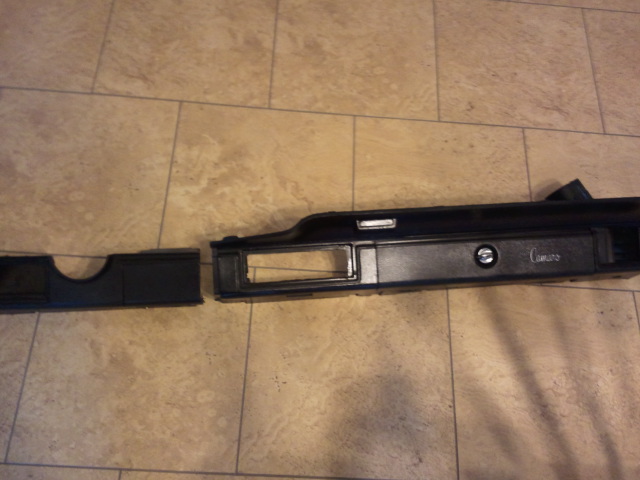

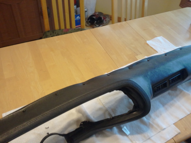

Got everything back together and went for a weekend trip to Jefferson city witch is about an hour north. The engine did not miss a beat. started every time and sounded great except for a slight ticking sound. I adjusted the rocker arms after I got home, but I have not had a chance to check if that fixed it as Im still working on the cooling fan.
In the mean time, I've removed my old dash and removed the glued on skin from the plastic backing. I plain to make a fiberglass copy of it to insure I get all the mounting points and tabs in the correct places. Then I'll smooth it out and reattach the lower half including the glove-box.
