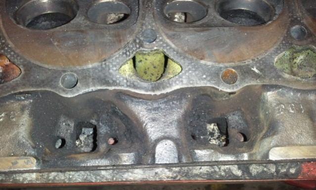

Originally Posted by oldman9
Good news and bad news.
I'll start with the bad.
Did anyone ever place a quarter on a railroad track for a train to run over and flatten out?
That's all of the barrings on the crank and connecting rods.
The block will be ok after I get it line bored I think. It seems like it just lost oil presser or something as ALL the barrings where spun or missing there tangs. It had an oil filter relocater with hook ups for an external oil cooler. I Really don't trust this thing at all.
The good news is that I'll be able to use the old crank for an interesting mailbox post.
All in all, I think I got my $50 from the heads and block.
Sounds like a candidate for a 383 build since you need a crank either way!

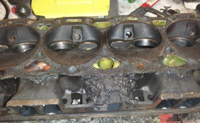

I've not gotten' much done lately with work and a case of strep throat keeping me busy.
I got the heads tore down and started chipping layers of carbon off. I picked up a top-end gasket kit, a new water pump with reverse spin, and a new alternator.
I still have the fried block on my engine stand and I'm using that to fab up the new brackets for the serpentine belt system.

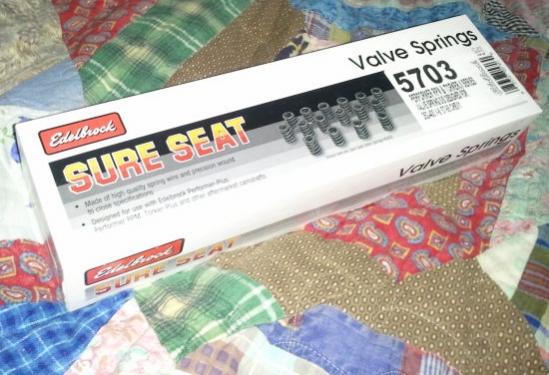

I got my new valve springs from o'rileys. I've never gotten brand new springs before. Is there anything I should do to them before I install them?
Old Oct 31, 2012 | 04:29 AM
  #289
You should measure the pocket depth. The correct way to do it involves a micrometer designed to fit where the springs go. Valve springs have an "installed height" this sets the seat pressure as well as the open. Its the distance between the seat and the retainer. If they are put in with the improper height the spring can be soft and not control the valve or it could be too tight and bind the spring before the valve fully opens.
They can be done without checking but I do not. The tool is $60 from Summit. Then there are shims that help you get the desired installed height. I think I saw a set with .010",.015", and .020", eight of each for $16. Someone else may chime in with more. My opinion is don't gamble here. Bad chit can happen. Even a set of dial calipers to get a rough idea of where the seat is in relationship to the retainer is better than nothing.

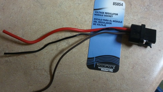

Thanks for the heads up on that. I called the machine shop here in town and they said they would assemble the heads for $55. I have them setting on the fried block still with a few bolts holding them down while I complete the brackets. I got to mounting the new alternator and noticed that it has the battery stud on the back and a 3 prong connector on the side. The old one only had a 2 prong one. Whats the 3rd wire for?
Large red
Small black
Small brown
