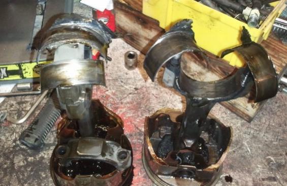

If the crank spun a bearing it rarely seizes the engine, but it could happen. I'd suspect you might find a cylinder that the piston is stuck once you get the engine completely apart.
Old Oct 19, 2012 | 09:56 AM
  #278
I once picked up a 4.3 from an Astro van that was seized. Appeared that the PO never changed the oil, and it was thicker than grease in the pan. The bearings had a melt down and bound themselves to the journals. Surprisingly, the crank was perfectly good after a little under-sizing.

Good news and bad news.
I'll start with the bad.
Did anyone ever place a quarter on a railroad track for a train to run over and flatten out?
That's all of the barrings on the crank and connecting rods.
The block will be ok after I get it line bored I think. It seems like it just lost oil presser or something as ALL the barrings where spun or missing there tangs. It had an oil filter relocater with hook ups for an external oil cooler. I Really don't trust this thing at all.
The good news is that I'll be able to use the old crank for an interesting mailbox post.
All in all, I think I got my $50 from the heads and block.
