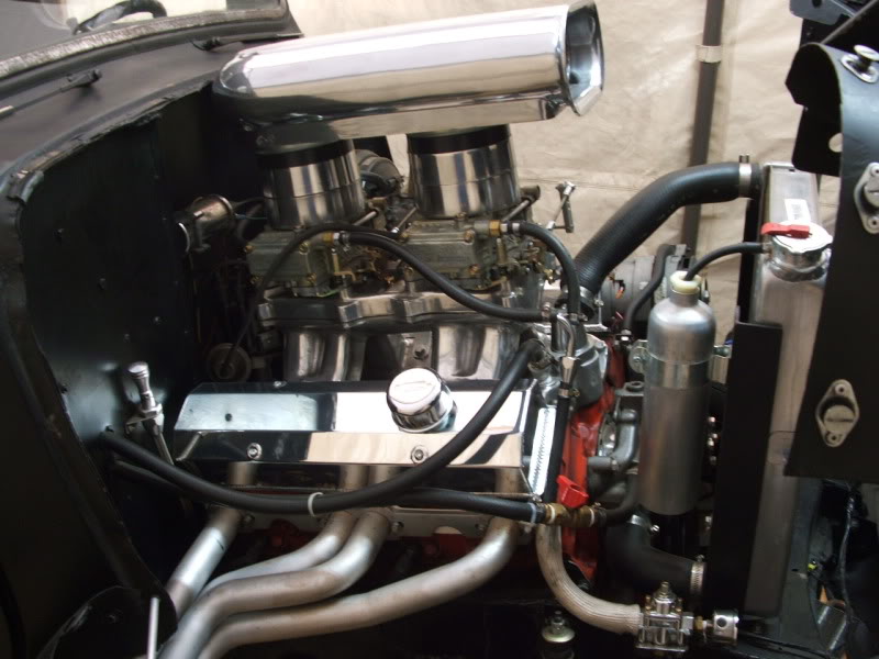

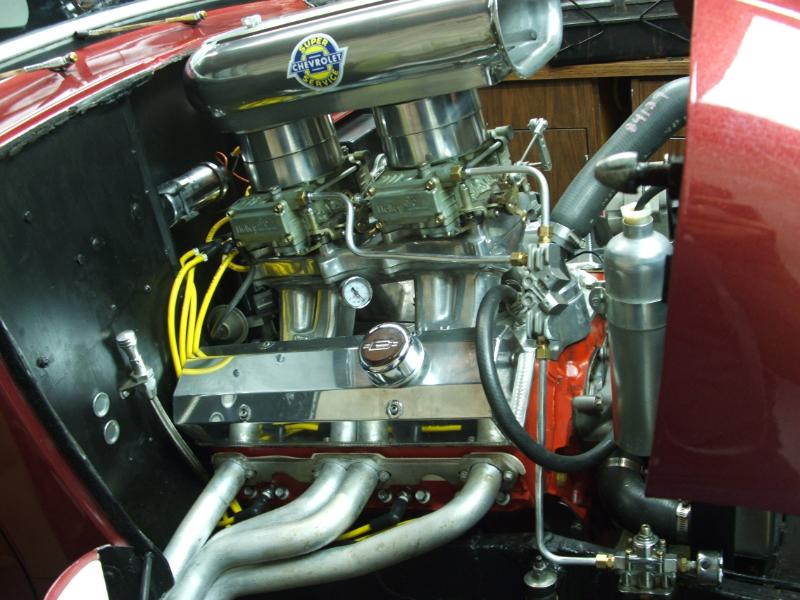

Old Jul 21, 2012 | 09:16 AM
Here's what I use on my OT gasser:
Had a ball valve in the heater loop, but heater started leaking, so I removed it until I can decide if I even need one on the car. You can see the red handle just in front of the pass. side head:
