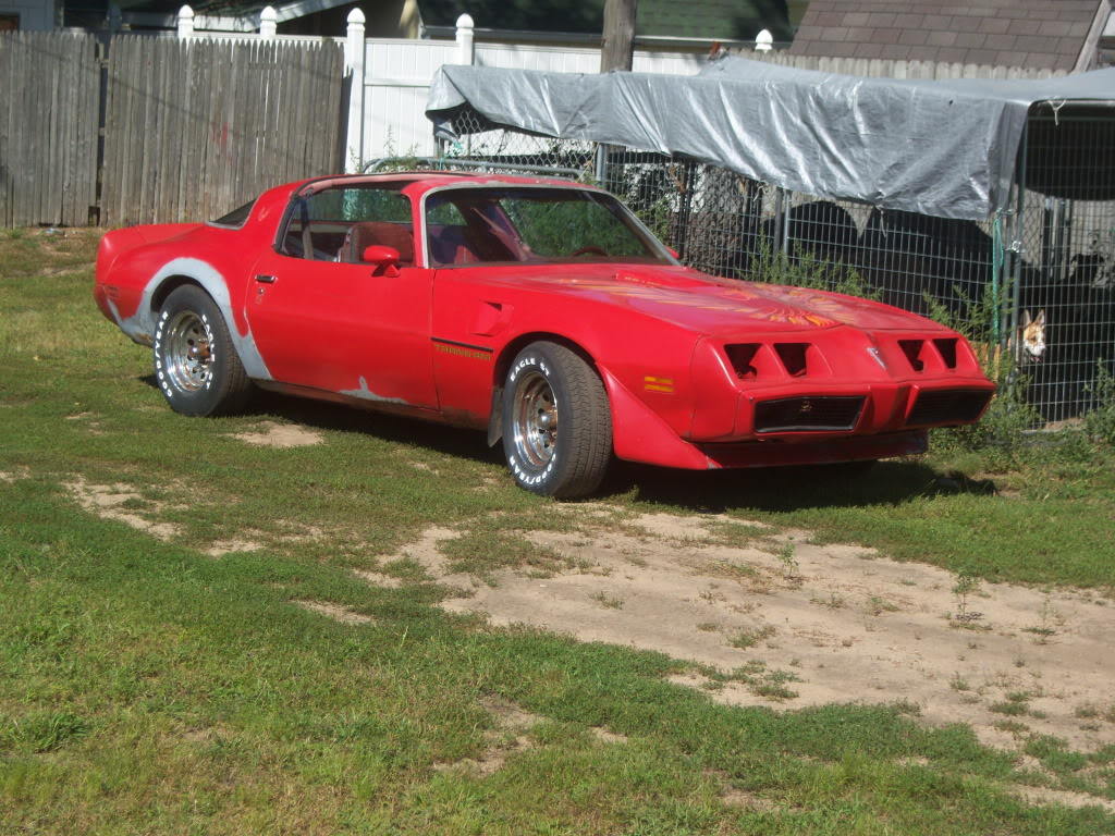

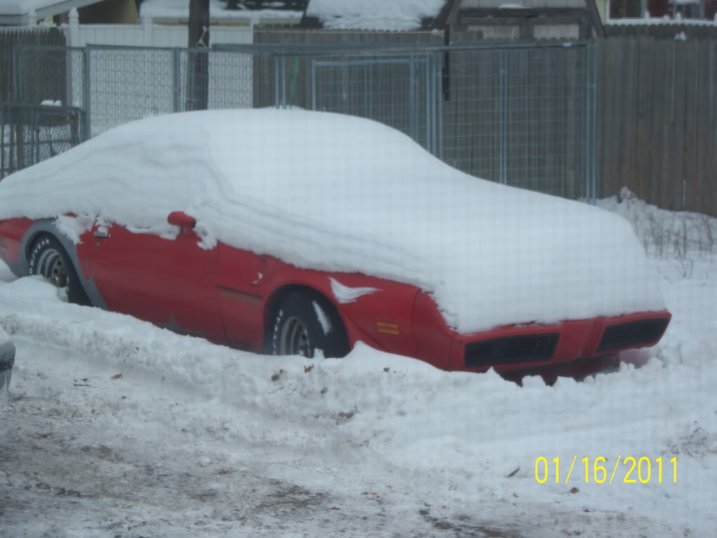

Her is some perspective. 6 months ago and this morningName:  010-7.jpg

Please tell me you put the t-tops back on lol

We're 55 degrees and raining!
