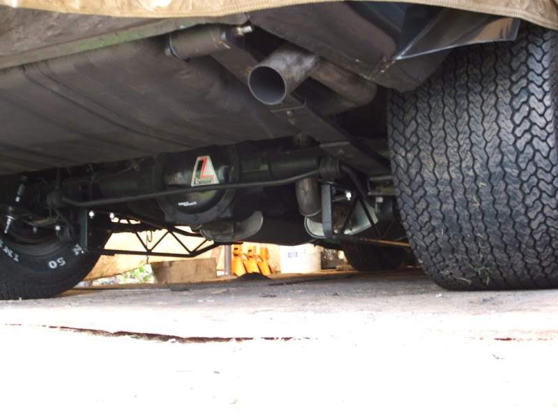

i did from the headers back to just before the pumpkin then ran the passenger side out the back last night,
the ASE mechanic was working on the driver side when i got there this morning...
took him from 8:30 till 12 to get that piece up over the axle and out the back...
i'm also a little irritated at how he did the rear hangers....
if my car looked like this when i came to pick it up, i wouldnt pay till it was done to my liking...

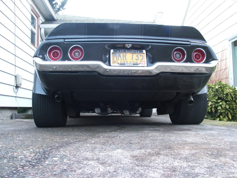

No offense, but if someone routed my exhaust system under my gas tank I wouldn't pay at all. Would have been nice if he'd mirror the pipes so they looked the same from the rear! I also would never install mufflers that close to the headers. The more tailpipe you have after the muffler, the more the exhaust will "rap" when you let off, or rev the engine. A longer primary pipe before the muffler will help it work.
Most kits situate the mufflers under the backseat, then route the tailpipe over the axle and outside the springs. Here's what mine looks like. A 4 hr. job at home in the driveway, with a $189 kit:

I'm sorry that is the worst exhaust I have ever seen. Not only would I not pay for it, I would be contemplating kicking the crap out of the installer. I love my exhaust shop even more now. Been going there for over 12 yrs and know the number by heart.
It looks like the rear end is gonna hit the over the axle pipes. I would get the kit Vall has immediately. Then have them pull it all off and give me my money back plus a $20 stupid tax.

so do you think that i can clear 3 inch coming out the back just like yours is? i'm going to be running 15x8 Basset D window wheels, but doubt i'll be as stuffed as you are in the back.
