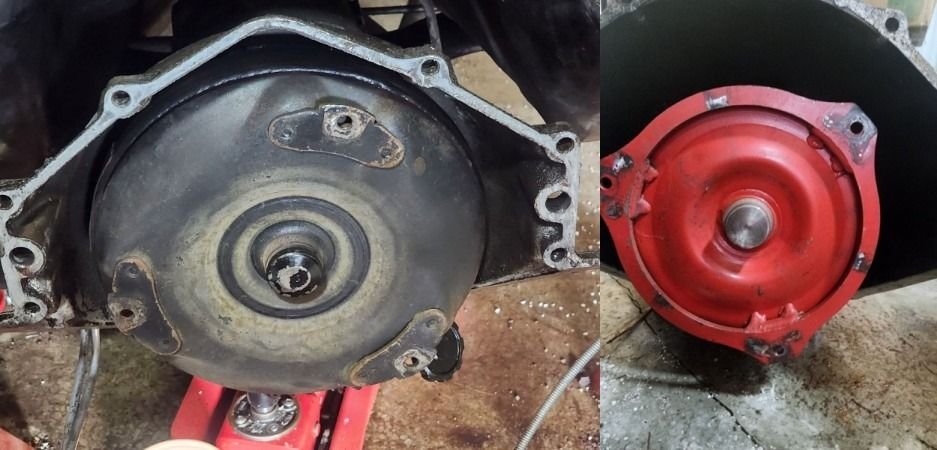

OK. I'm swapping a 383 into my 69 which has a T400. The 383 had a T350 with a Hughes 3000 RPM TC attached.
I want to keep the T400 in there, as this swap is temporary. If I go with a T350, I'd need a different driveshaft (T350, out of a 3rd gen, is shorter.) I researched the crap out of swapping the flexplate since both engines are externally balanced, to discover that's a no-go.
But then, I stumbled on to the conventional knowledge that a T350 TC will fit on a T400. If I could swap the TC's that would solve a lot of issues, making this swap essentially a bolt in (I also scored SBC headers for a 69)

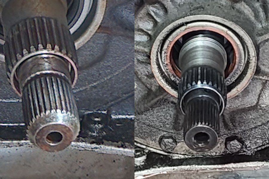

So, I attempted to make the TC swap. I'd looked at the pump shafts and on a quick inspection, they appeared to be identical.
Well, as it turned out, that requires the word "almost."
I took pictures as I'm kinda keeping a journal for all of this so my daughter, who will ultimately get the 69, can understand what's happening... and also for any further mechanical issues down the road.
That said, I cannot get the donor (T350) TC to seat on the T400.
I can get it on the shaft. I feel it engage the serrated edge. But I can't get that final "thunk", and the distance between the front pump and the end of the shaft on the TC is about an inch, the surface of the TC itself and the edge of the bell housing is about a half inch inside.
When I look at the output shafts, I notice a substantial "nose" on the end of the T400 shaft,, maybe 3/8's of an inch.
Is that what keeps it from seating?
Anyway, at this point, I'm open for suggestions. Am I overlooking something? The T350 TC is SUPPOSED to fit, Is that incorrect? Can the front of the T350 TC be enlarged a small amount so the shaft can get that last, critical space?
I don't speak transmission or torque converter, so thanks in advance for your help.
