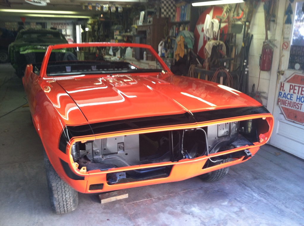

Hi all,
Project car is starting to eat my lunch money. So this is my dilemma. After determining that my sons 67 had a C-Clip eliminator modification performed on it I went out and found an original equipment rear axle from a Nova.
The gears that came in the 67 are 2.56, don't honestly know if they were stock or not. At this point the car is far from original equipment so it's not a factor.
The gears that came from the Nova are 4.11's.
Currently it has a M22 Transmission and a Small Block 350 that came out of a 72 C-10 pickup truck according to the engine stamp. Don't know how long the engine will last and at this point I don't know what kind of performance I'm getting out of it. All I know is it was running when we started the project.
Question: What would you put in it for gears assuming I keep the M22 and 350? This is just a good looking street driver, not looking snap any necks off the line.
Thanks for the help.

4.11s aren't going to be too bad as long as it's not driven on the highway. If you want something a little better for cruising, anything between 3.23 and 3.73 will still give good performance while remaining fuel friendly.

Agree, something to think about, with a stock size tire, 3.73's, and a 1:1 fourth gear ratio, engine rpm will be around 3000 at 60 mph.
mikes68 Dec 22, 2012 05:56 PM
again 3.73 and i love the color
