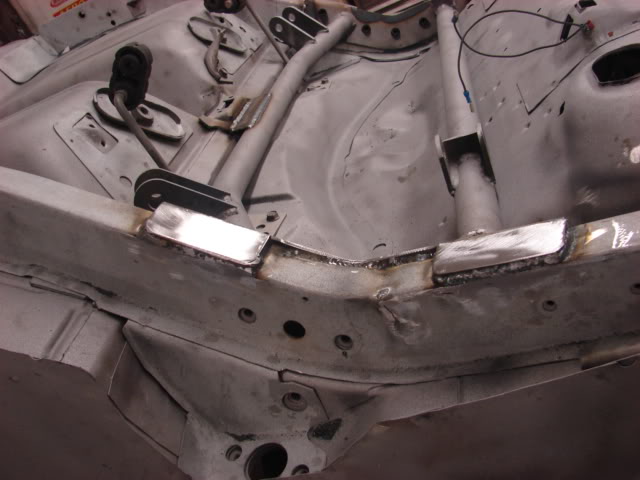

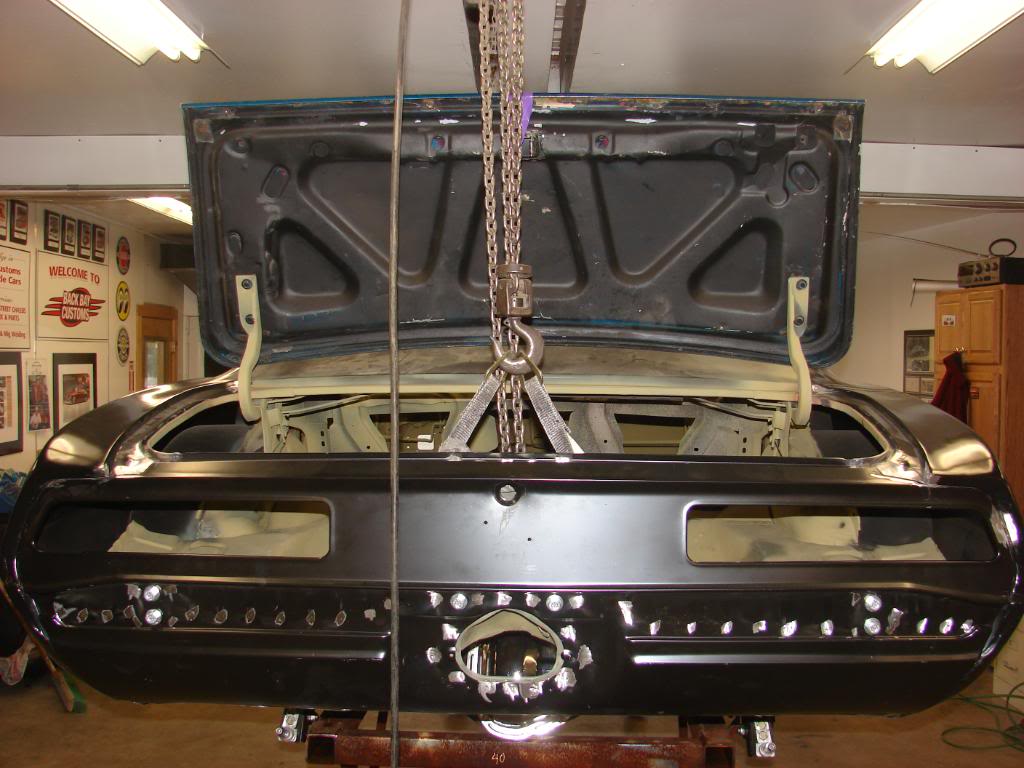

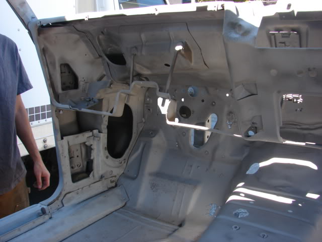

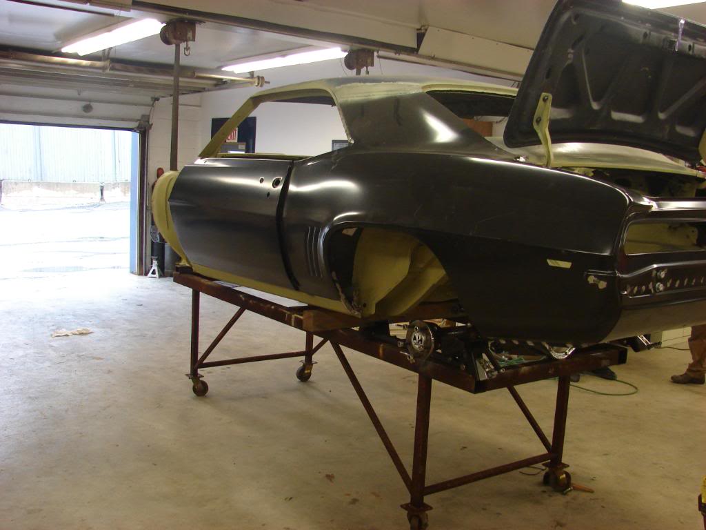

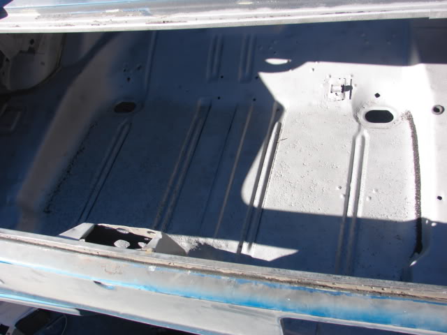

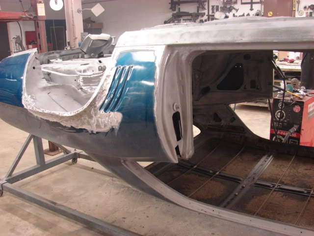

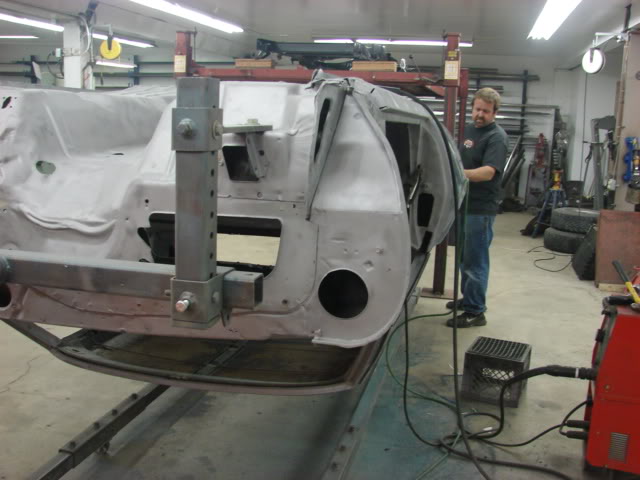

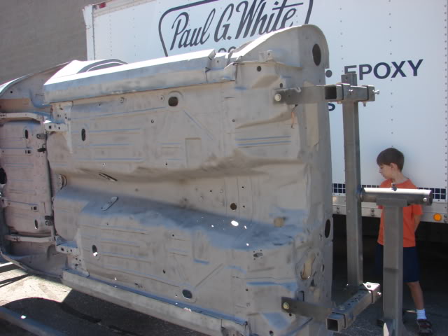

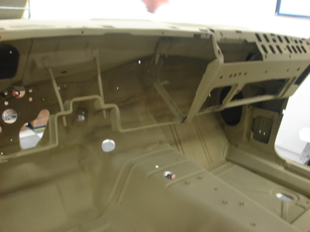

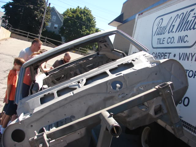

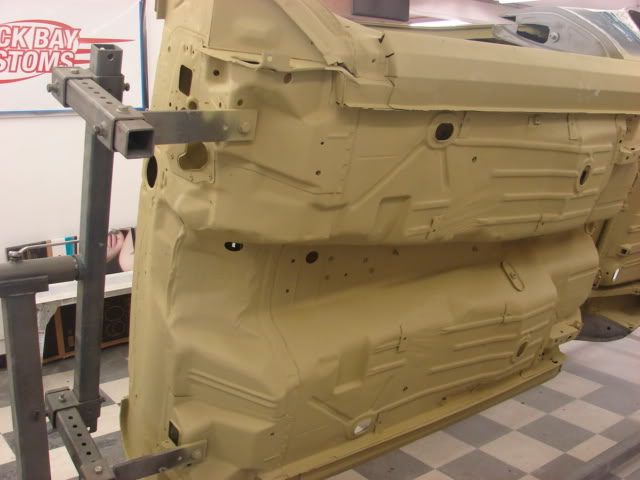

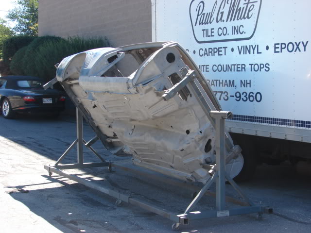

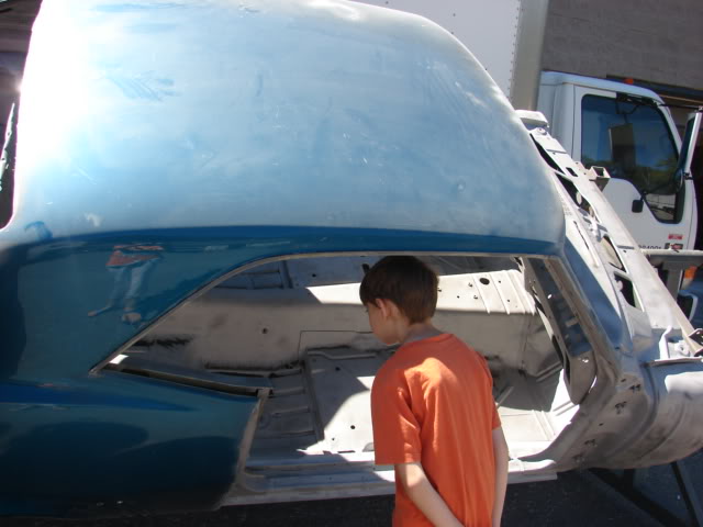

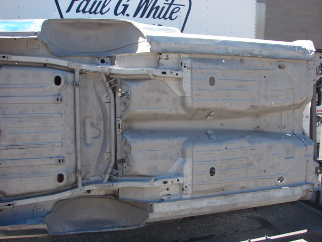

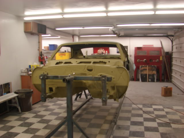

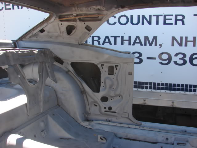

I just wanted to post a few pics of the car at the shop. Only been there 2 weeks and the sub-frame has been repaired (cracks and reinforcement needed for the air ride shocks) and sent off to powder coat. Body is on the rotisserie and blasted. Shop is really impressed with how good condition the body was actually in, which of course means I save some $$$. Floors need nothing, and there is some pitting in the trunk due to leaks around the rear window frame. They will replace the body panel making up the lower window frame (between rear window and trunk), and a couple small patches to the rear wheel wells is all that's really needed. I gave the shop until March before I needed the car done, so I can start putting it back together. I think I'll probably have it back by Thanksgiving. I just hope it continues to go this smoothly. I only have the shop blasting, straightening, gaps, and body reassembly, and custom paint. I'm doing the reassembly (I did the disassembly). The new parts going on when done include :

Here are a few pics of the car now.

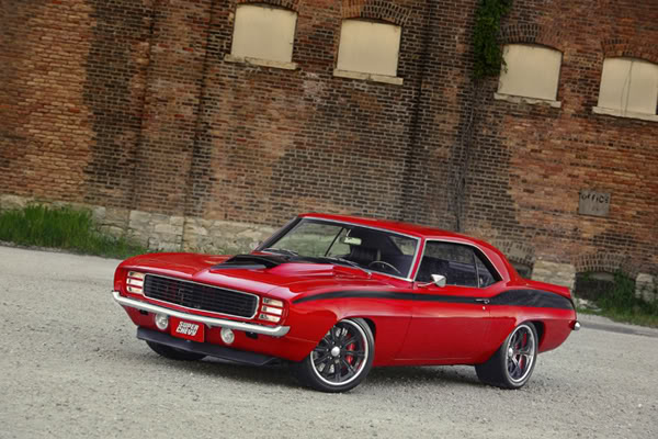

And this is still what I'm basing my build on. The car will be the Grey color of the "Elenaor Mustang" from Gone in Sixty Seconds instead of red, but the rest basically the same (including the ghost flags since I've been in the Navy 21 years, I Love the flag).

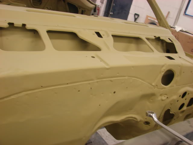

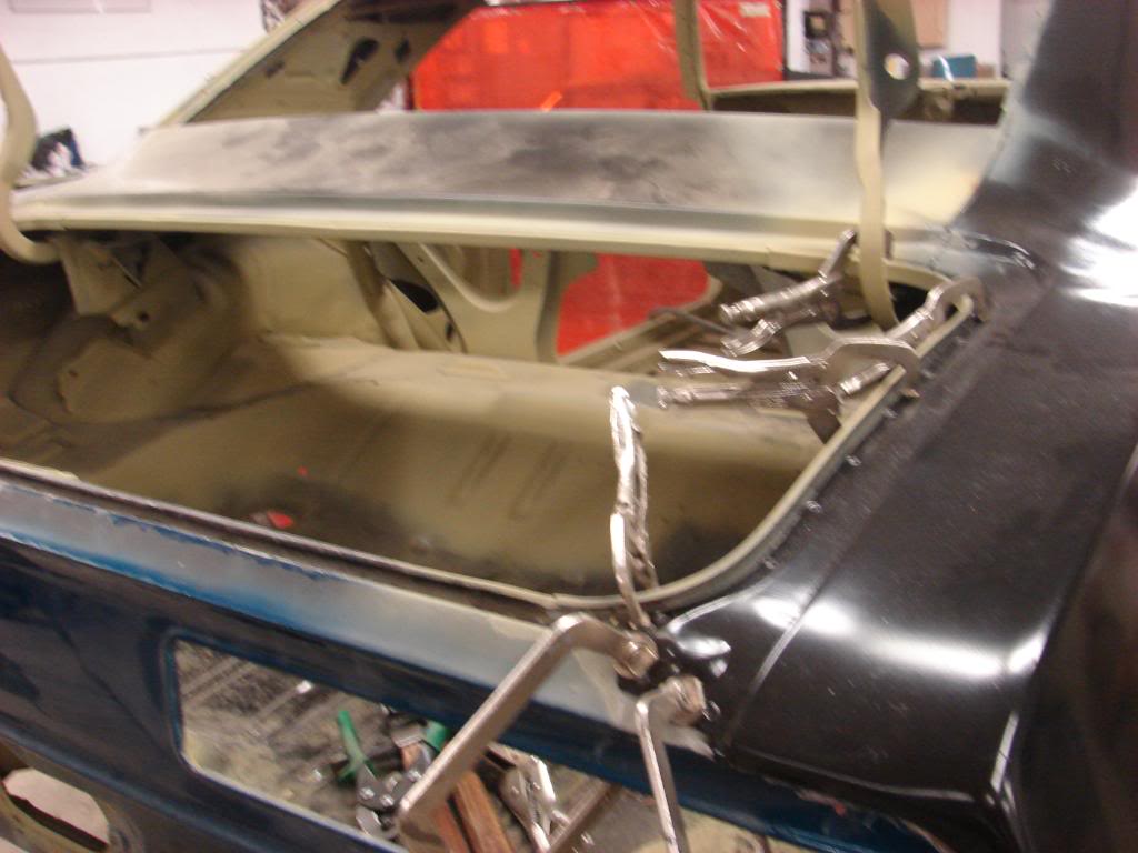

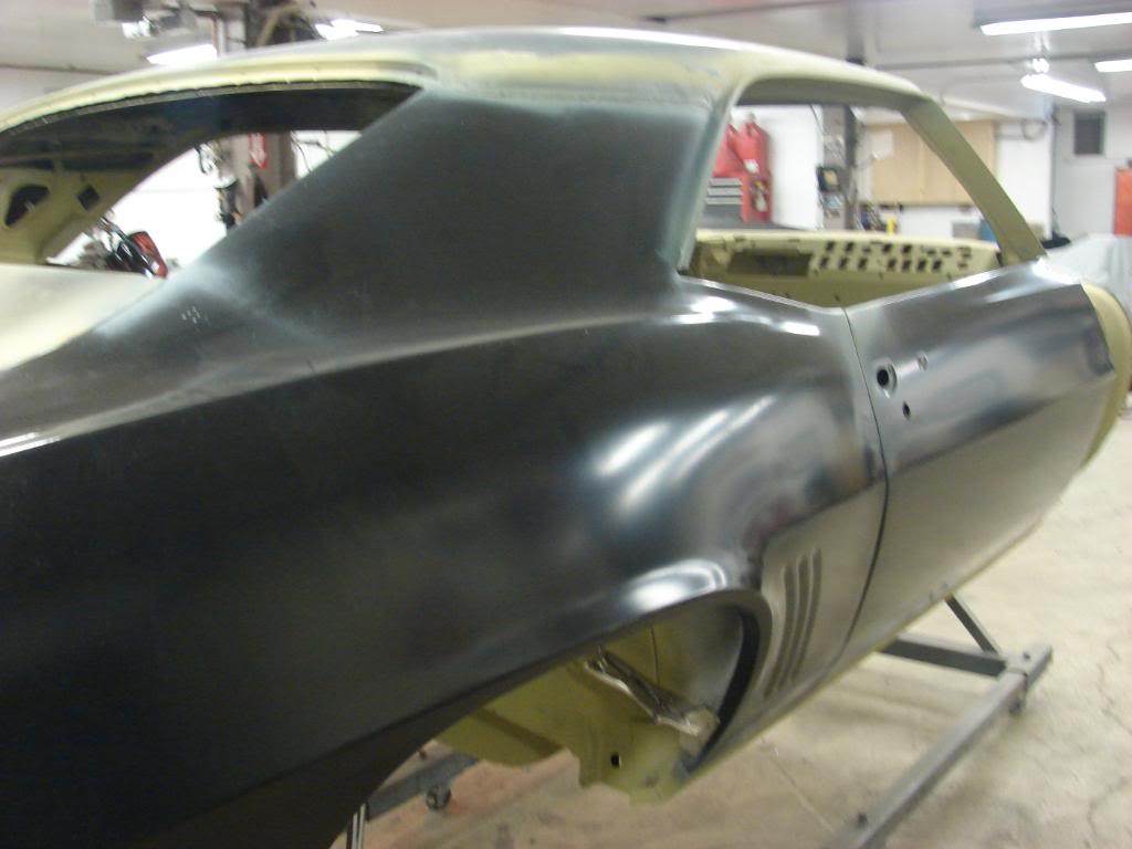

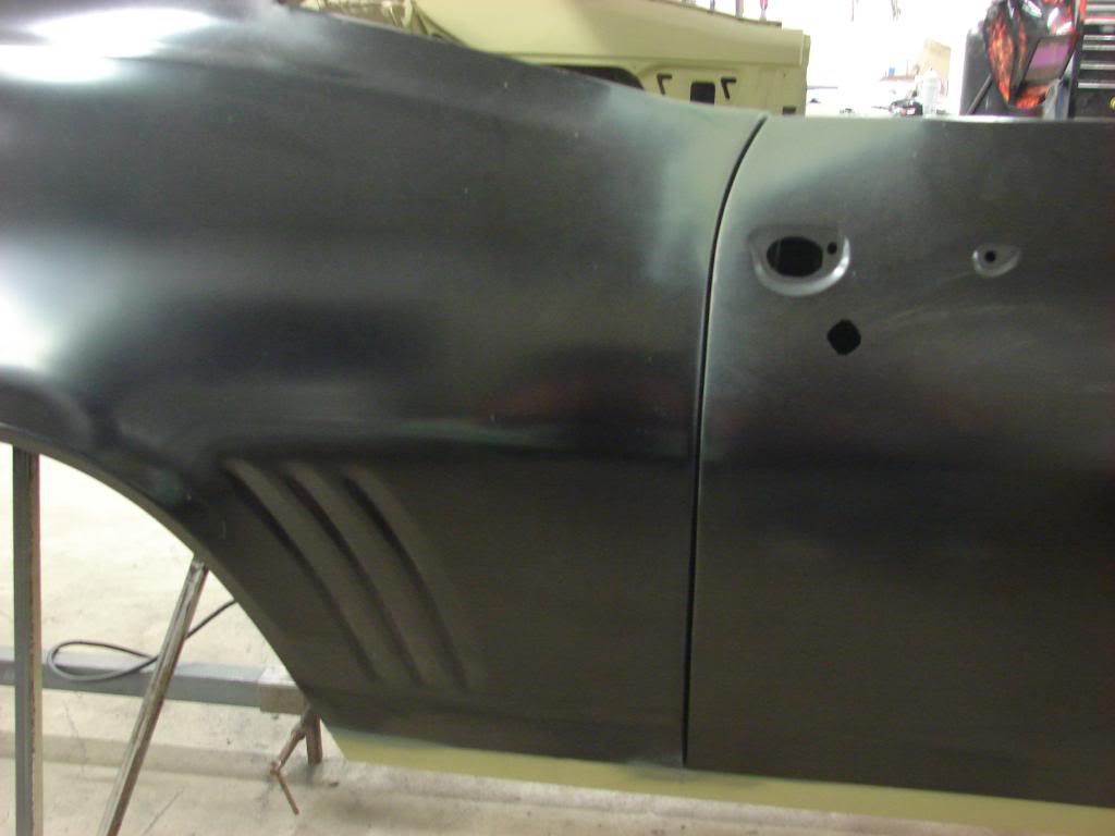

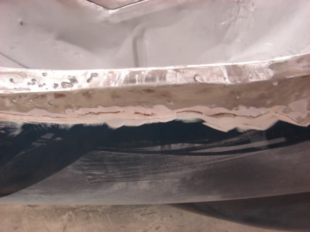

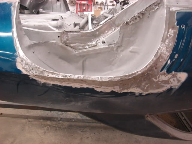

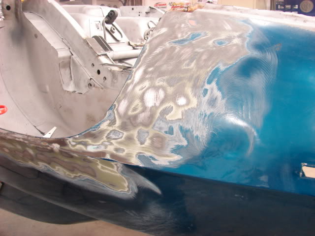

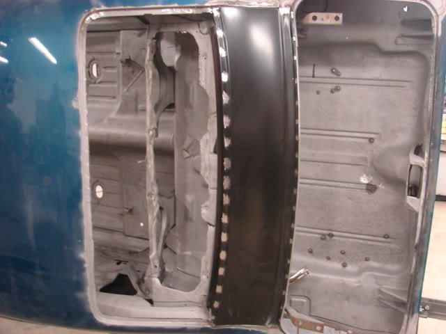

More pics from today. Turns out the rear quarters are in worse shape than I thought and will change them out. Although the bondo layer was not super thick, just too beat up from some p*ss poor prior repair.

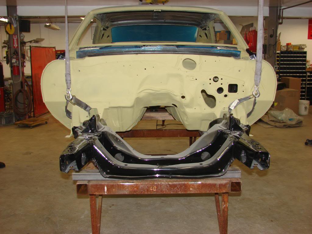

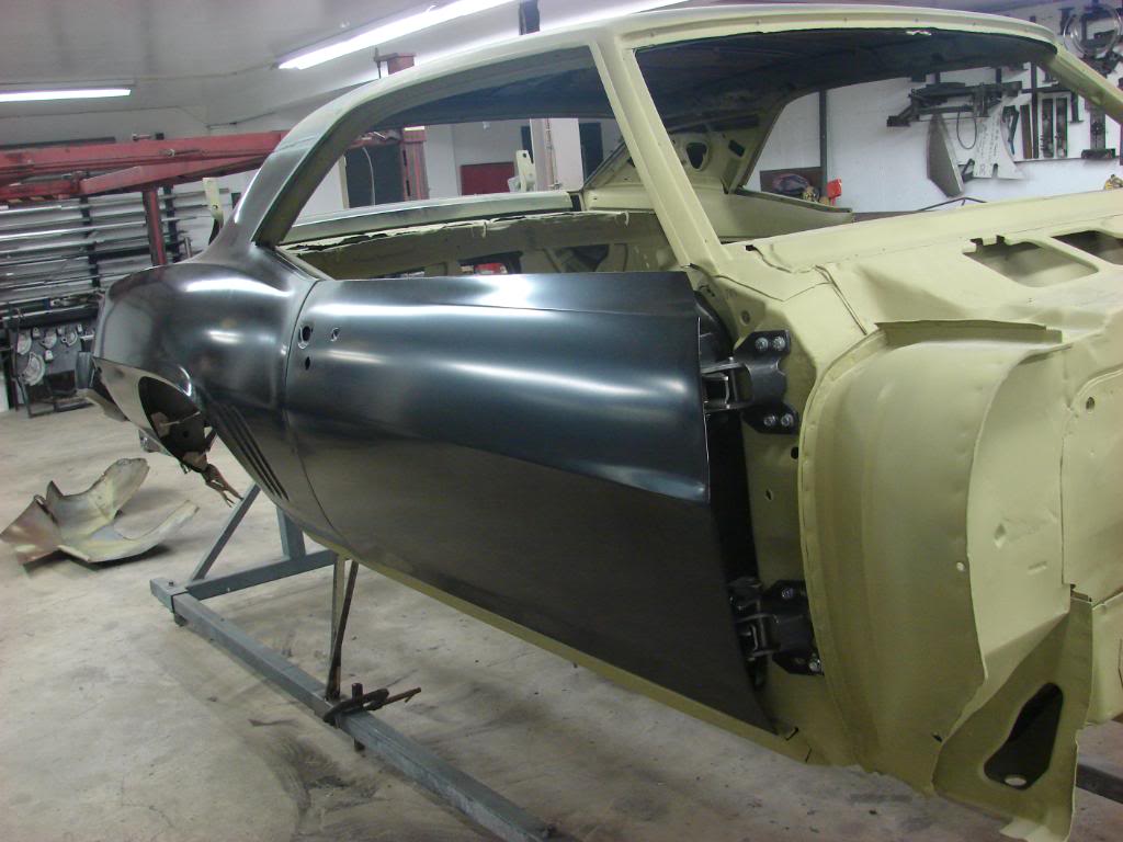

Here are a couple pics of the progress as of yesterday. The shop got the passenger rear quarter and door fit up. Still ahead of schedule. But damn, going through $$$$ FAST!
Derrick

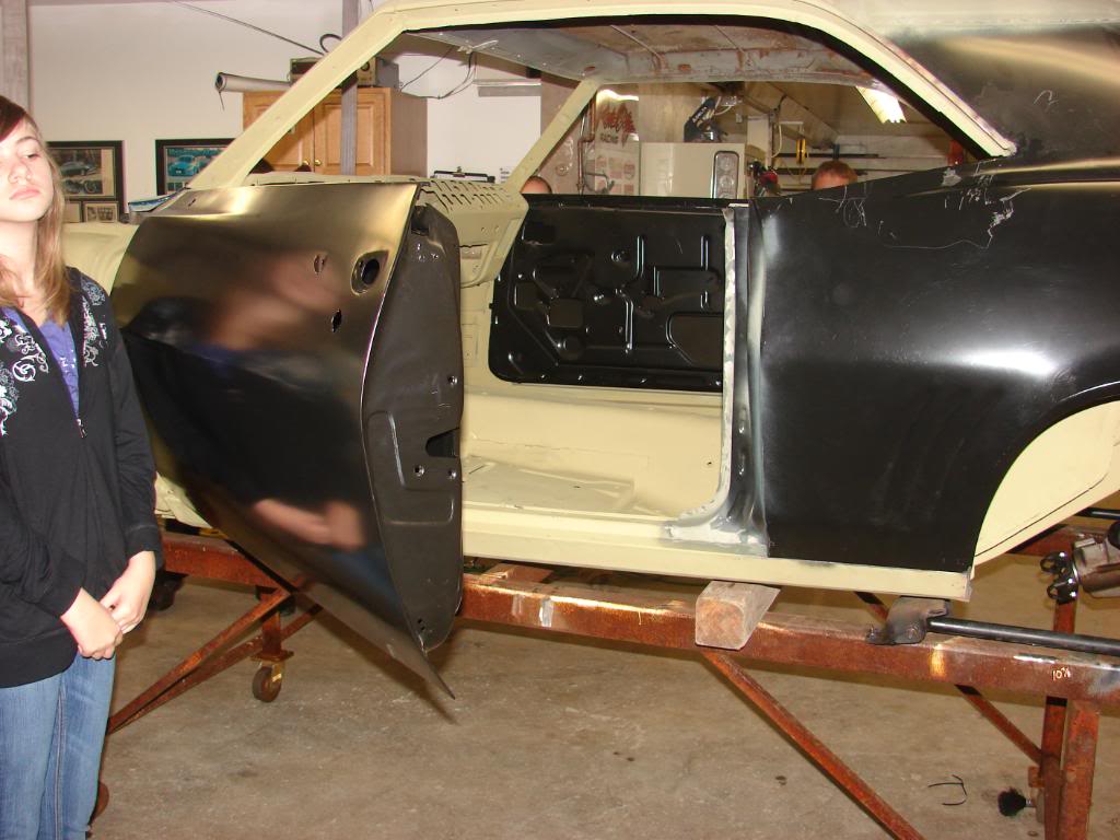

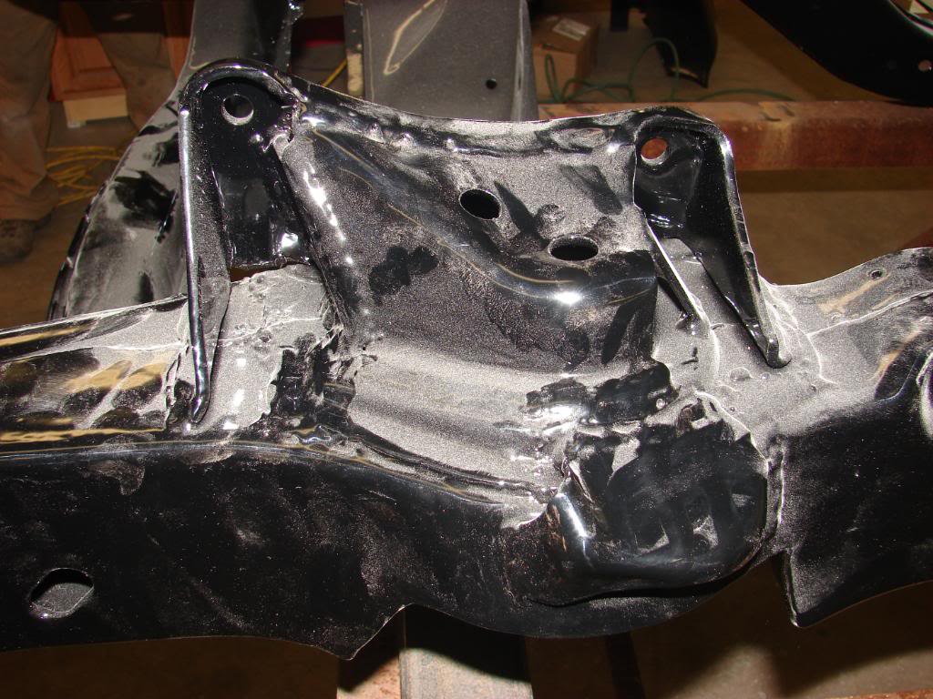

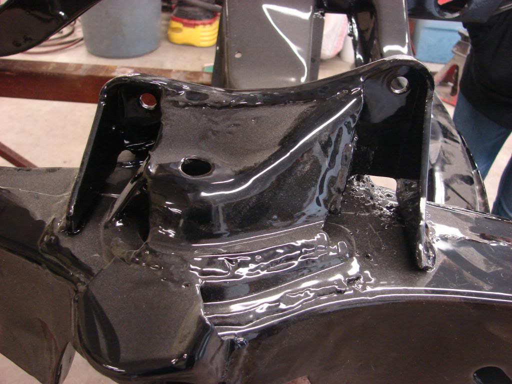

Went to check on the progress of the car today. Next week I have to make the final paint code decision so it's WAYYYY ahead of schedule. The shop was hanging the front end today. Interesting problem though that they worked through. The damn door hinges from Goodmark don't allow the doors to open all the way and fitment was HORRIBLE. Very disappointed. I finally got to see the frame today. Powdercoated gloss black and very pretty. Here are a couple pics. I included pics of he shock mounts with the reinforcements due to the air ride breaking the welds several times.
