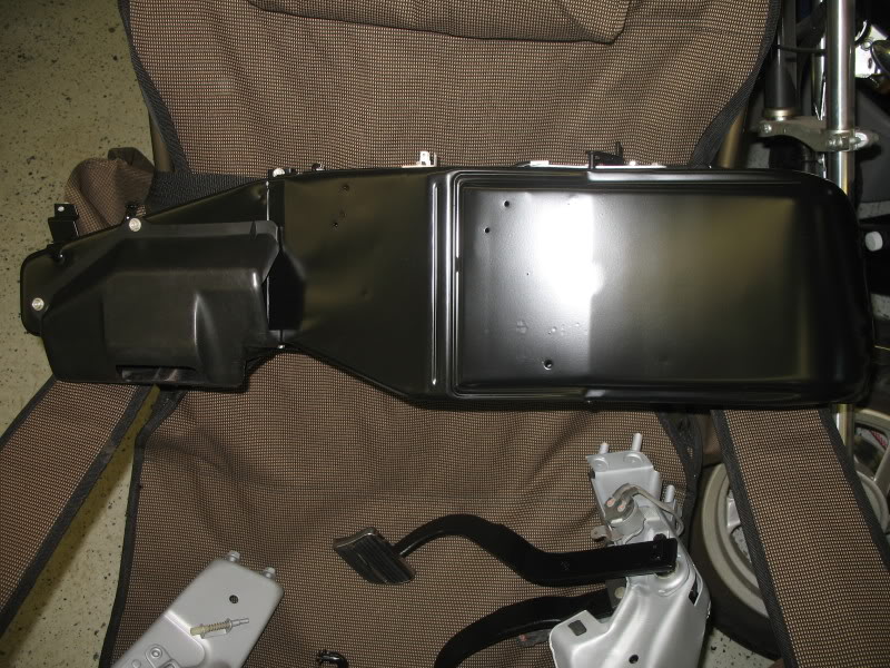

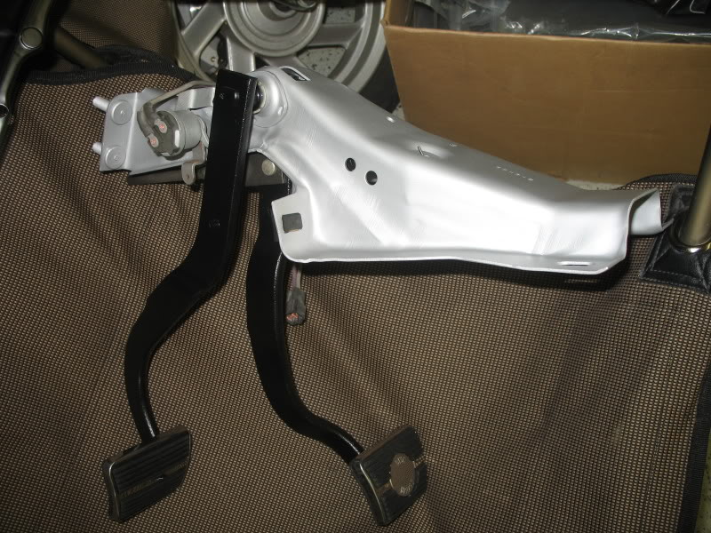

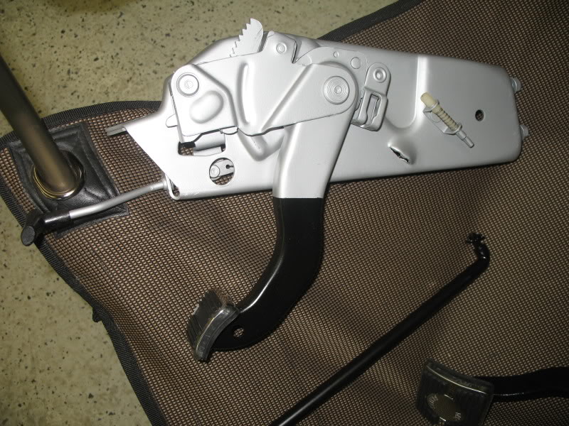

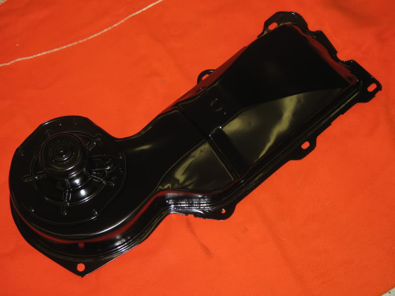

Messed around in the garage today, cleaning and detailing a few things that needed done, and require mostly time and almost no money. Pretty much all of this ('cept the wiper motor) I glass-beaded and then refinished. Some of those things that have to be done, but nobody enjoys doing.
Emergency Brake Bracket:
Peddle Assembly:
Wiper Motor:
Heater Box, outside:
Heater Box, Inside:

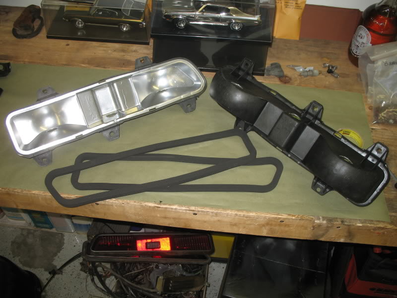

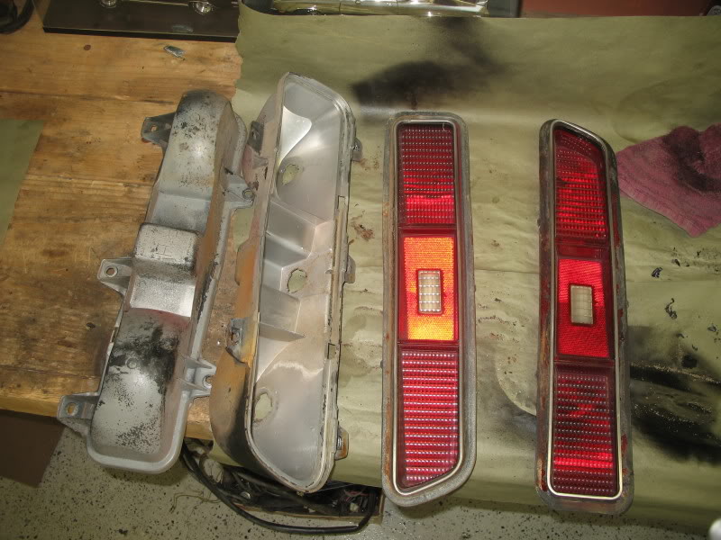

The next thing we will cover will be the taillight assemblies:

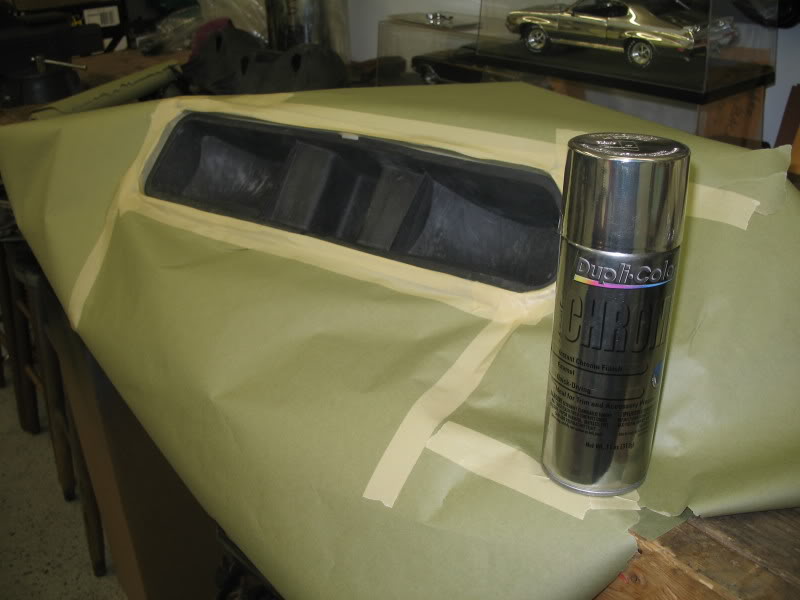

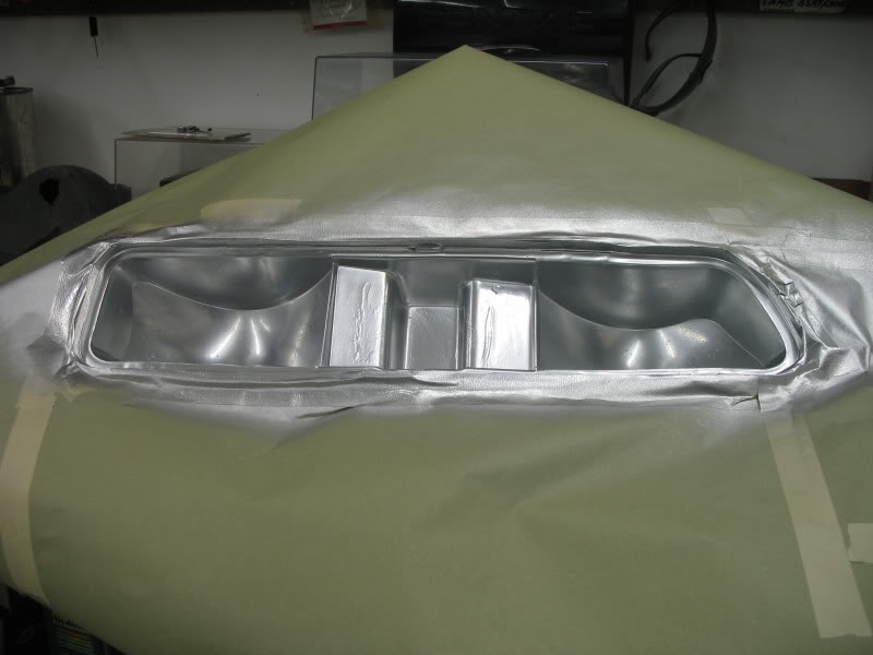

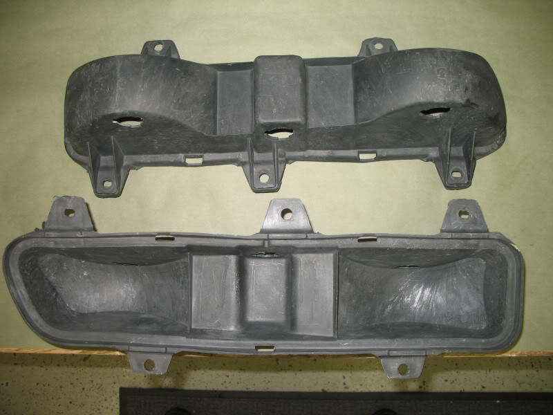

I really enjoy taking an old rusting relic, and saving it from the crusher. I finished the tail light housings tonight. I started by disassembling as shown above. After I cleaned all the seam sealer and gooey stuff off of them, I then wiped them down with wax and grease remover and glassbeaded the housings, inside and out. The glass bead won't damage any soft surfaces such as plastic and rubber, as long as you don't hold it on one area for an extended period of time. I then cleaned them thoroughly with fantastic, and then very hot soapy water. After taping off the inside I used plasticote spray "Chrome" and coated the inside of the bezels. I have used white paint before and got the lights very bright as well. Then I wipe down the outside and spray them with "Matte-Clear" from Krylon (Works well on A/C boxes, too). It keeps the finish even and fresh looking, and holds up great. Take a look below:

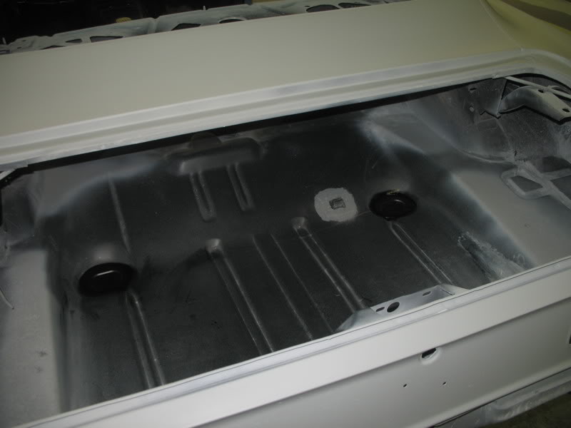

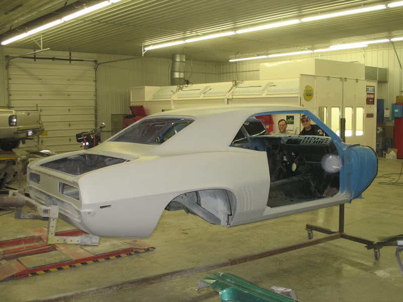

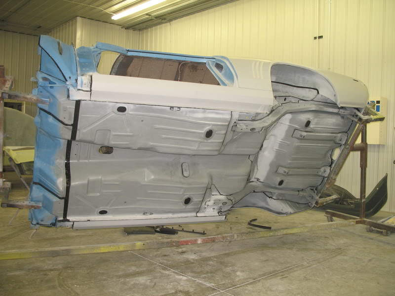

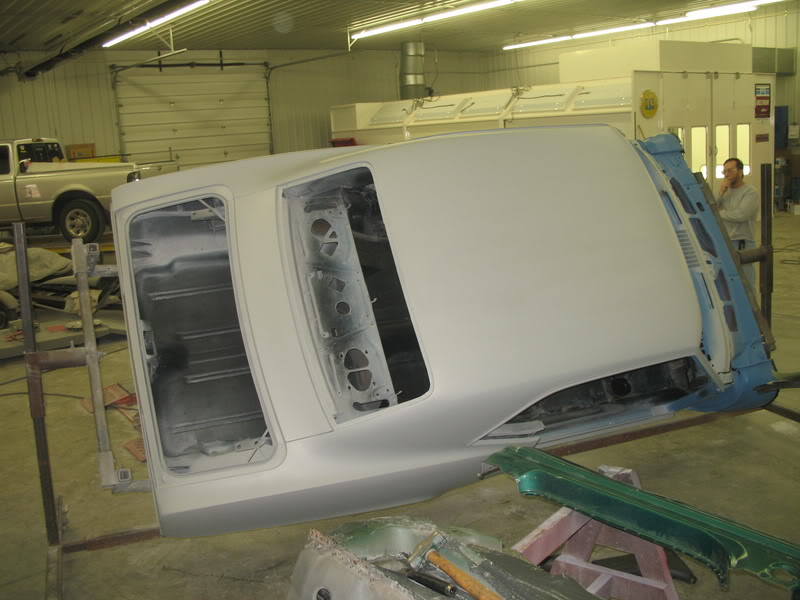

Seam sealer is on, body is primed and blocked and ready to seal. The bottom should be painted monday or tuesday, and then I will get it back and put the suspension on. I have to make room in my garage for it....since I have been off work, I have been doing metal work on a friends '70 Chevelle, 454 SS that he purchased in 1971.

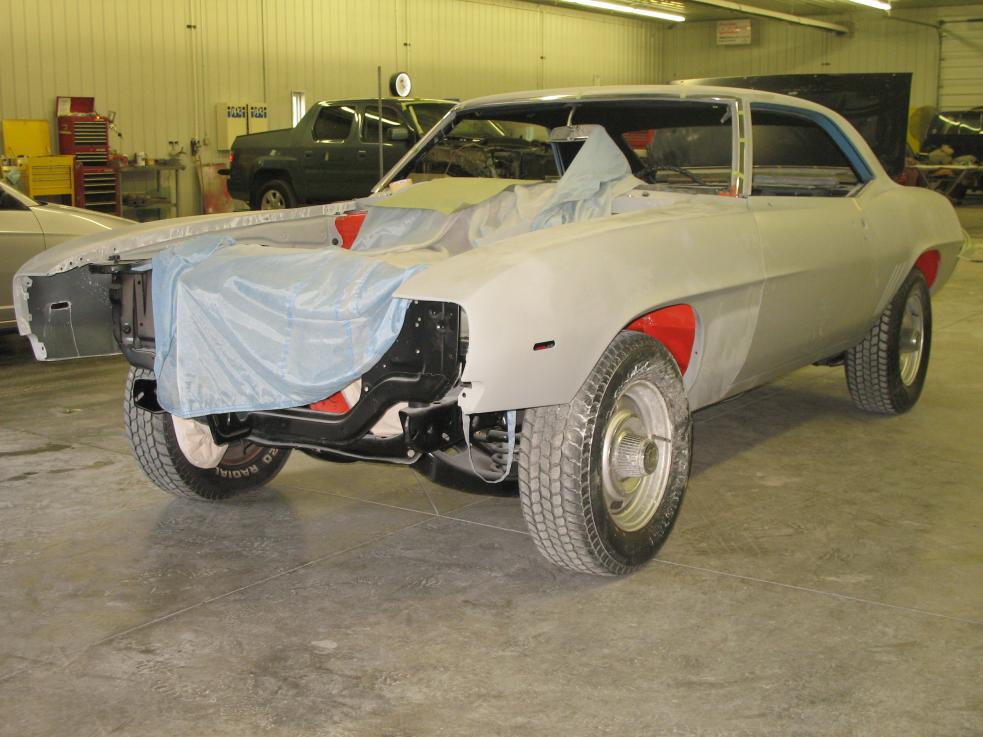

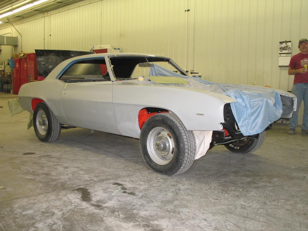

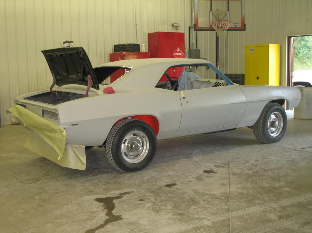

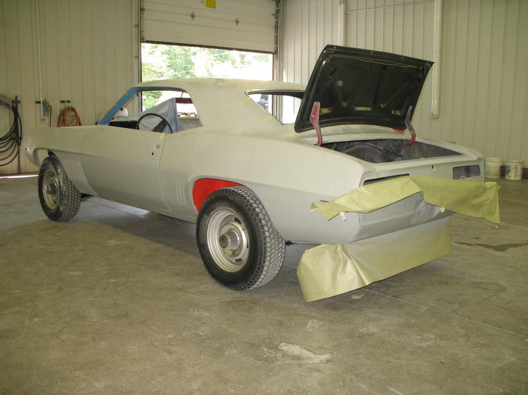

Stopped by the body shop today, and Mark is back working on my car. I told him I was back to work and I think he would like to get the car back to me as much as I would like to have it back.
Attached Thumbnails My progress on my 69 street machine...to date-69-2009-0904-001.jpg   My progress on my 69 street machine...to date-69-2009-0904-002.jpg   My progress on my 69 street machine...to date-69-2009-0904-003.jpg   My progress on my 69 street machine...to date-69-2009-0904-004.jpg
