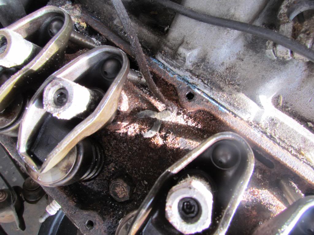

Gunk in the heads. I actually drove it like this for about 20 minutes one day.:

stuff living in the heater core cavity:
Under the valve cover:

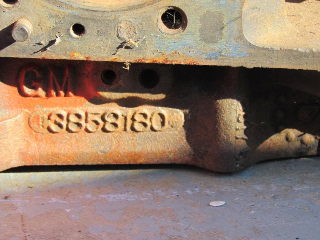

a 327 block I was thinking ov putting in before I got the 350... might still build it as a trophy.

You do have your work cut out for you, glad to see you plan on keeping and restoring your 69. I seem to remember quite a while back you considering getting rid of it. What size (width and dia.) are those rally wheels? I might be interested when the time comes. Also, those heads are over the counter 1969-70 Chevy 350, 64cc chamber, 1.94" intake, 1.5" exhaust valves, with 160cc intake runners. They're definitely not Pontiac, Chevy and Pontiac are totally different, non-interchangeable engines.

69, This is what I was told about the heads.. I actually researched them before and found them to be the same as what you just posted. I know they will fit the 350, I just dont know if they will be better that the iron ones that came with the engine. I will get some pics of those posted up soon as well.

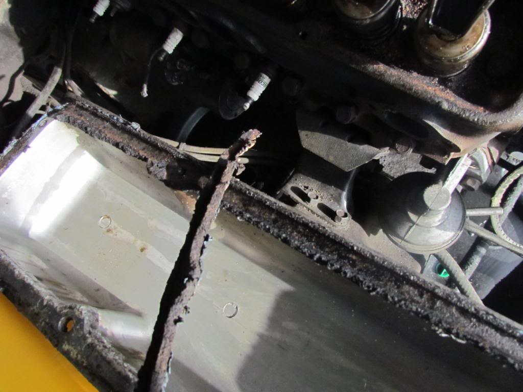

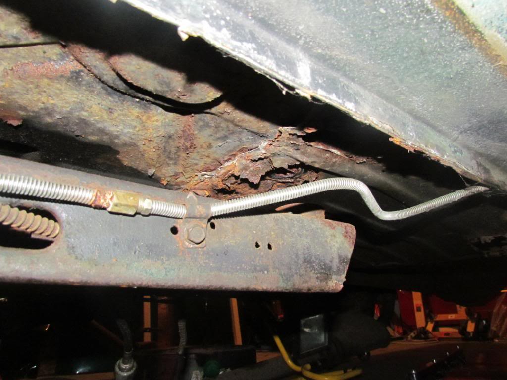

OK, well its been almost a year... time for an update... pics to follow. Im enrolled in a university and still have a full time job so my time with the car is limited. However, over the last week ive made more progress that in the last 4 years or so. The subframe is almost off....
Old Oct 18, 2012 | 11:26 PM
  #96
cplthomas's Avatar
HELP ME TOM CRUISE
Yaaarrrrrr
Joined: Oct 2006
Posts: 4,010

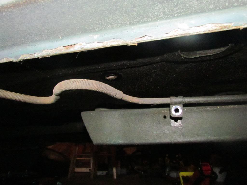

This is under the drivers seat. where the subfamr connected. Yeah, pretty solid huh?

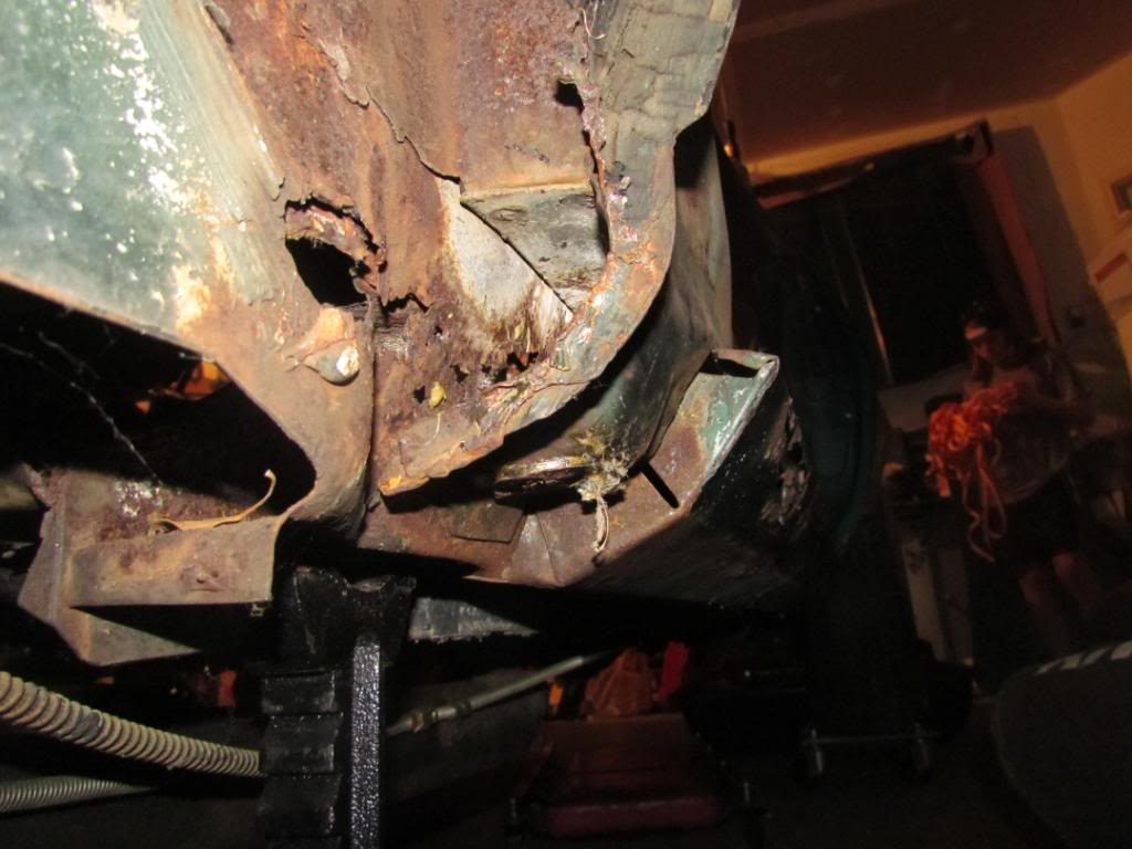

This is some goop and a few nuts and a bolt. my best guess is it is a glob of fiberglass hardner stuff with some hardware mixed in. It is all comming out, unless it has sound deadening properties....

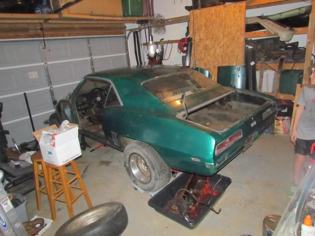

Here it is as it sits in the garage right now.... hopefully I can get back to it soon.

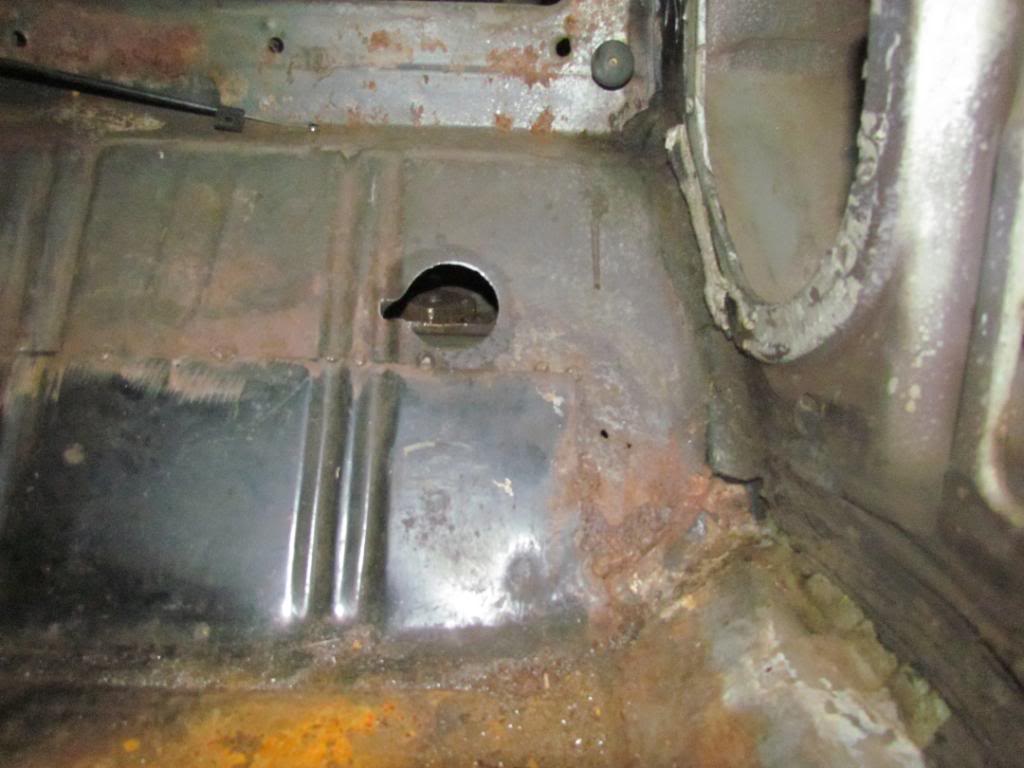

The nut (for the sub frame) under the at the passanger side fire wall was a real chore. I had to cut a hole in the floor to get a wrench in to it. What a pain.

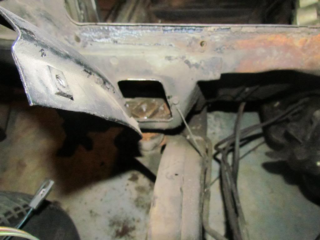

The sub is loose but not comming off. I will have to look at it in the morning. I know there is a line to disconnect... I just need to figgure out what else is still connected.
