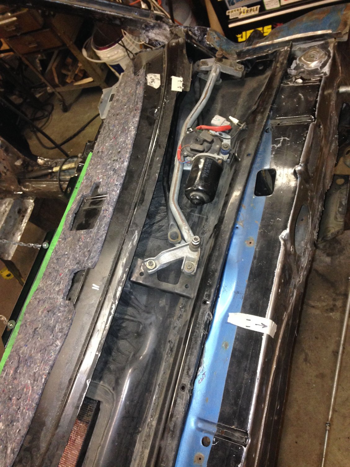

The wiper assembly and top cowl will be most challenging as the GTO is curved and wiper motor and arms are hideaway of course so I'll get fancy but conforming later.
