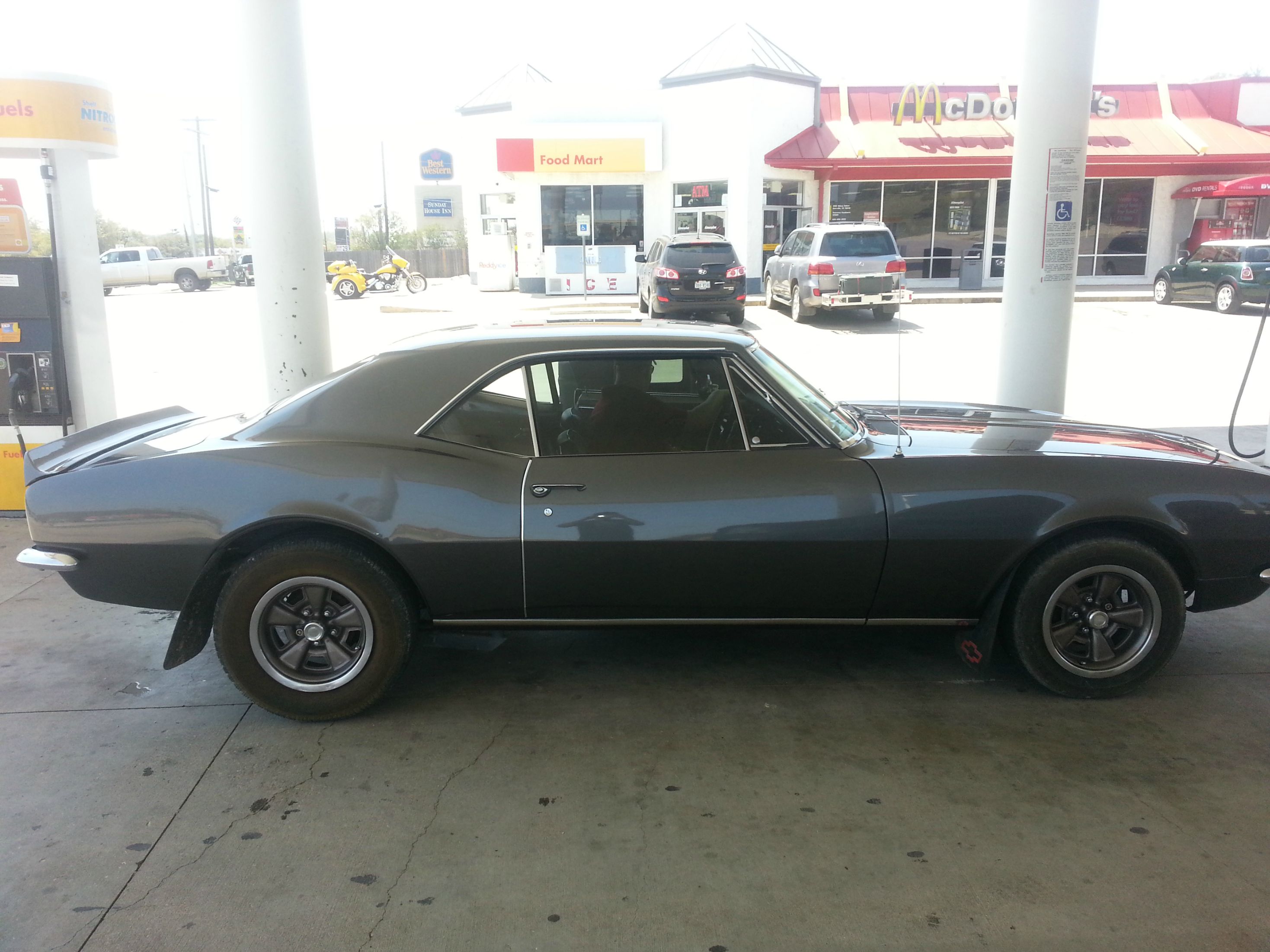

Probably not necessary to know it's a 67 Camaro since the engine is from a old Chevy truck and completely rebuilt. Anyways, it's my dads and he just picked it up, needs an alternator though.
It currently has part number 7127m-3. Looks to be a Driveworks remanned 61 amp.
http://shop.advanceautoparts.com/web...rks_5030250-p#
So my question is what is a suitable replacement, something that will wire right up and fit the bracket. He wants a chrome one and maybe something pumping a little more juice.
Pics of the car:
