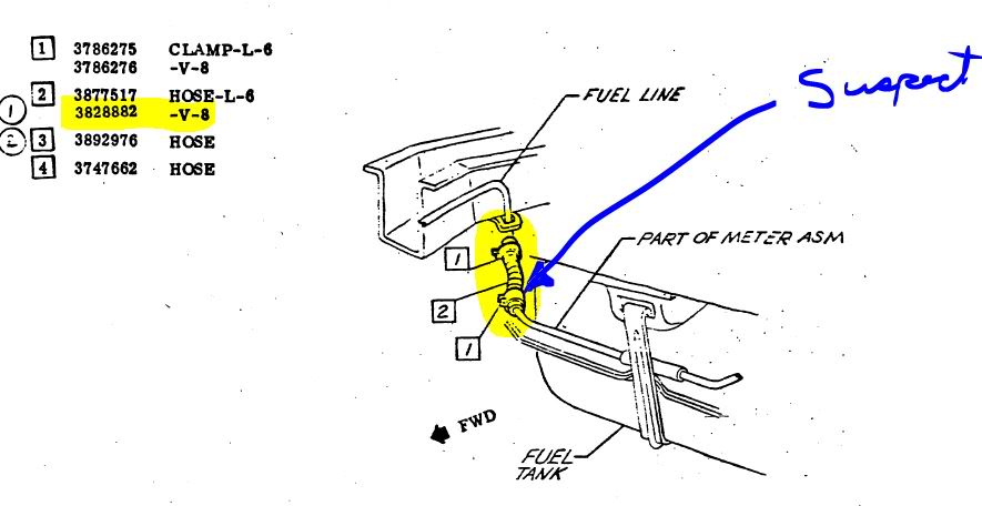

There is a short piece of 3/8 inch fuel hose that connects the hard line on the fuel sending unit to the hard fuel line running along the underside of the car. You may have to drain and lower the tank to get to the sending unit side.

Looking at the assembly manual, sheet 8-B1, I think I see the hose in question. Since the part number does not give me any returns when searching, can I safely assume that this can be replaced with a piece of 3/8" hose from my local parts store cut to length? I'm hoping that the clamp on the sender side is loose and the cause. That would seem to be the easiest fix.

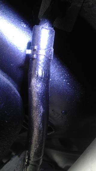

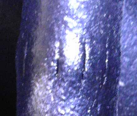

I got some time today and got it back on the jacks for a closer look. The hose was cracked pretty good.

A closer look

well theres your problem.
and yes just get some 3/8" rubber fuel line from a local parts house and cut it to length.
