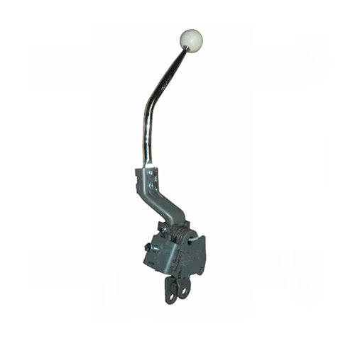

1 Attachment(s)
For a shifter to work in a console car you have to have to offset shifter handle. Otherwise the console will prohibit the shifter from being able to get into reverse. 68-69 console bases are the same, holes are the same.
Attachment 16385
Camaro 69 01-26-2013 05:54 PM
I did it the budget way on my first 69, heated and bent the chrome shifter arm to give it a dog-leg right and up. Nobody will ever know once the boot is on.
Doing that does shorten the shifter though, which was fine with me. Consider it a poor man's short throw!

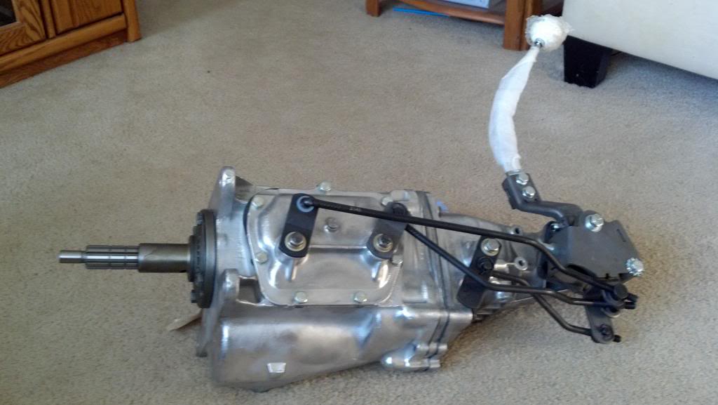

mikes68 01-26-2013 08:06 PM
thanks guys just closed the garage door we got the new muncie in and the new shifter and the console with gauges it cost a good buck but looks sweet and there was a tag on the back side of the carpet with date of apr 1968 thought that was cool cant wait for spring to get her back out on the street lol

mikes68 01-27-2013 12:27 PM
1 Attachment(s)
Attachment 16382 guys you will have to let me no if you can see the pictures am just guessing on how to post pictures
mikes68 01-27-2013 12:33 PM
1 Attachment(s)
Attachment 16381 guess it worked tryed it from my phone and it worked lol need to get a boot for the shifter and put the original radio in or get a new 1 not sure yet
