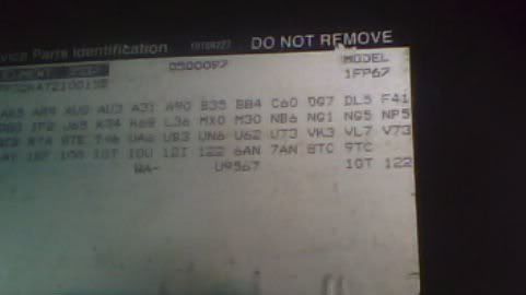

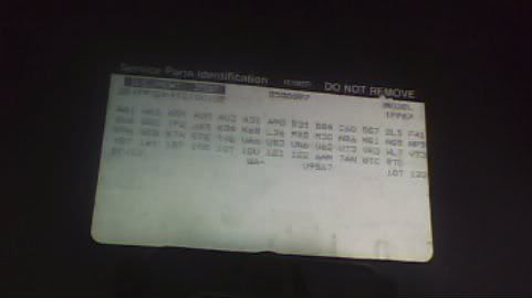

as for it being a Y87, IT IS! and here are some crappy pics of the RPO codes

Looks good and glad you have the Y87 pkg. IF you are wondering about the rest of your RPOs here is a great site for decoding them
http://cadillacfaq.com/rpo/index.php
I have used this for many years and they have always been on the money.
