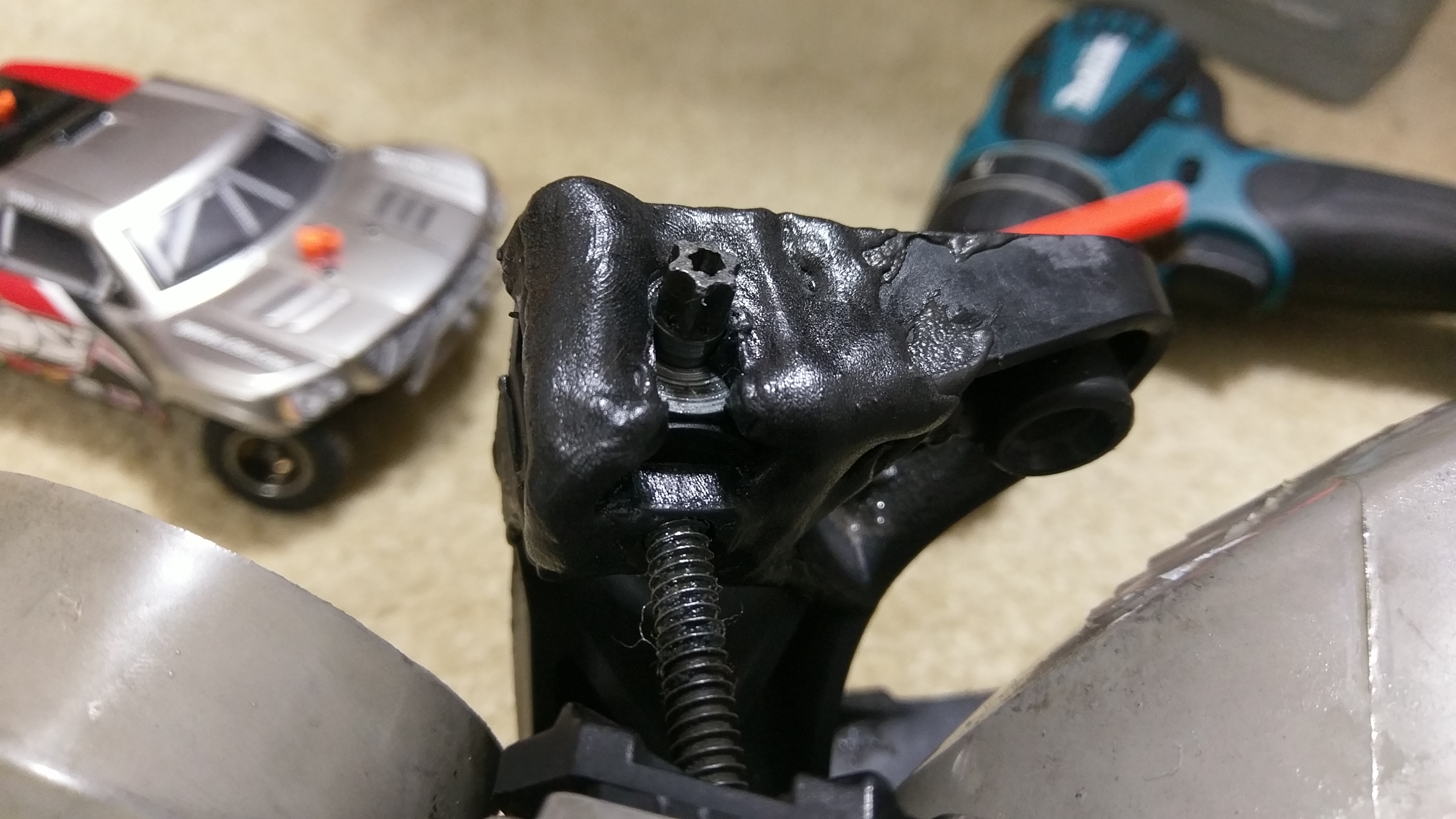

I kind of broke something on my headlight housing though. The adjuster (I guess that's what you'd call it) broke on me. The driver side headlamp, on the star-bit adjuster that controls up and down beam angle (the one that's in-board, not on the side near the fender) is broken. The plastic that the 2 cog gears are held inside of has literally exploded apart, I guess some dirt got wedged in there, and it's now in two pieces. I can't find a part number for 'beam adjuster' or 'headlight adjuster' and GM Parts direct just lists it as ONE UNIT being the entire lamp housing.
If this is how it is, I guess it's after-market lamp housings now, as mine is dead. I have some JB weld plastic blend on hand that I'll try tomorrow, but I don't have high hopes for that being permanent. Sucks too, because I kind of like the old 'sebring' style lights. OEM housings are just too expensive though, $270 new for each side here locally.
-edit-
Well, it appears the beam adjusters are PART of each housing, not a separate-purchase item. UGHHHH. JB Weld and some dreams for right now until my tax return gets here.
-edit-

it is different from 97 to 98 ,may need a new head light,unless you can get the mechanizam from another head light there touchy,an theres no bubble on the 98-02 need a wall to adjust them ,the ones i got for my car clears were 119,00 on ebay shipped pair.an they look great,with the hockey stick spape led lights ,came with everything plug an play ,not just shells plug an play ,other then we had to hook the running light. built in to the running lights as there is sperate wire ,one could go without them but i like them you see it in the pic below ,at that time the light needed adjusted up. they are the r8 style an $125.00 dot .comes with a set of fogs you can toss ebaymy picture below

It's not permanent, and it's not pretty, but it'll work for now until I get my yearly struggle dealing with identity theft and my tax return back.
