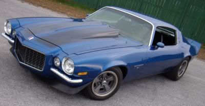

from looking at this pic...it looks like it a 3 piece spoiler..there should be a few bolts that holds it on...im googling as fast as i can lol
after googling for 10 min, from what ive read there no difference between the 2 trunk lids..and on ebay theres spoilers for at the most $35
