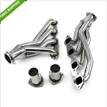

greencamaro1981, yeah subframe connectors are already bought, wasn't a problem figuring that part out even though it's a mild build. Gearbox? 1971BB427, my only other concern was headers. We have sidepipes, so are considering these rear dump collectors. I know Hooker Competition has full length that work well but want to keep the sidepipes. My last concern actually was the tall aluminum valve covers we have. Heard they might hit the power brake booster. Thanks guys!

Yes, the tall valve covers will definitely not clear a stock booster. You'll need one of the small after market boosters. Might be an issue on the heater box side too. I'm not sure on those shorty headers with angle rear collectors, as you didn't mention the brand. I know Hedman will clear everything with a similar design:
http://www.summitracing.com/parts/he...maro/year/1972
